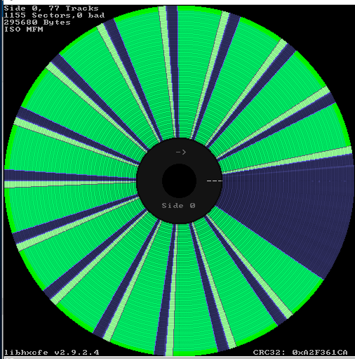

When I use the Gotek with the hXc firmware to format the hfe file in the machine I got read error in the end.
When I open the file with track analyser, the data is everywhere on the disk, it´s not consistent!
But when I use a Gotek with FF firmware, there is´t a problem, I can fomat it with out a problem, and when I open that file in track analyser, all look good.
So I don´t know if there is a parameter I missed in the hxc software or what it is?
I have done no configuration on the Gotek drive, just a jumper on S0 and the same hfe file on the USB stick.
I have attached two screenshots which shows the differens between the the files.
- fomated with hxc.PNG (183.08 KiB) Viewed 40202 times
- formated with FF.PNG (154.38 KiB) Viewed 40202 times

Please share the HFE files or send me them to hxc2001 at hxc2001.com, i will have a closer look.
i suspect that there is a bitrate/rpm setting issue.

I will ty to explain what I did; I used OmniFlop, it could read the disk, when it was reading the disk I saw the numbers 77/1/256 somewhere.
Then when I saved the disk to a img-file OmniFlop only wanted to save it as a 80/2/512 image. I don´t know if it´s because the disk was pre-fomated as a IBM-PC disk once and Omniflop wanted to save it as that.
Then I took that img-file and converted it to a HFE-file in the Floppy disk emulator software and transfered it to a USB-stick.
The machine could not read that file, it timed-out on that command. But I could format the disk-image in the machine, but with hXc firmware I got a read error at the end.
Than I used the other Gotek with the other firmware that I had lying around just to try something, and it could finish the format without errors.
After that I opened the newly formated HFE-file in the track analyser and saw that the machine had formated over the first 77 tracks on side 0 with 15 sectors that was 256kB each.
And that is the HFE-file I using now and it´s seems to work with FF but with hXc there is some timing issues or something.
