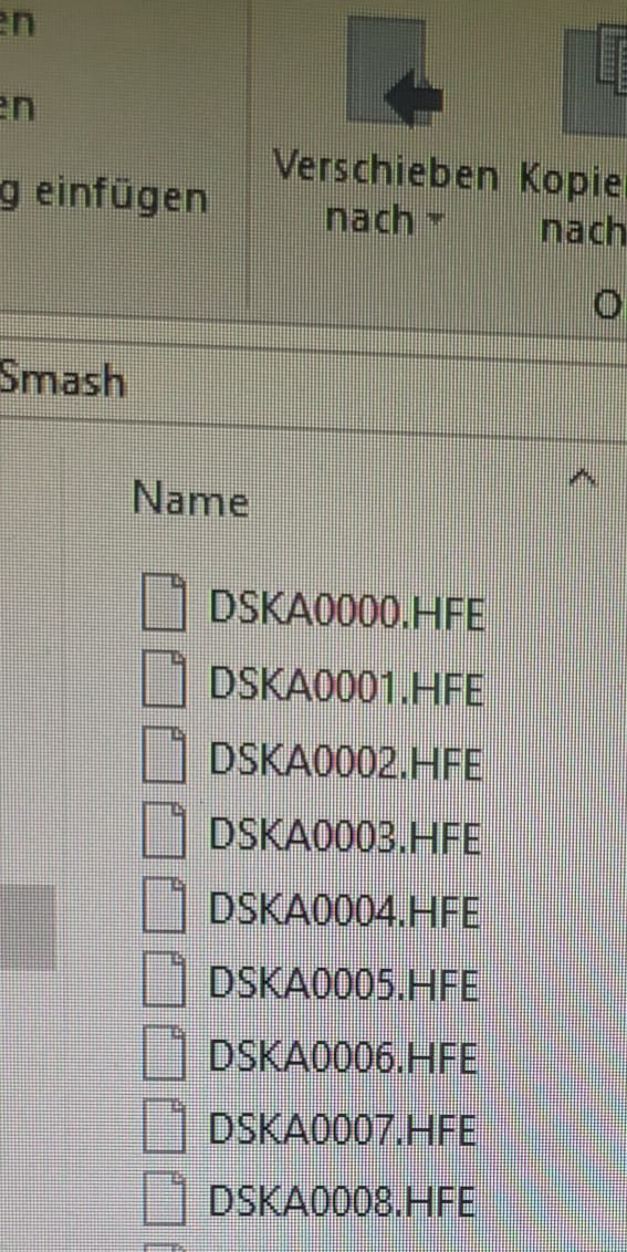

I have Build in my Korg Triton Classic an QD (QuickDisc) Gotek USB Floppy Emulator, The Seller by Ebay has installing the Firmware for my Korg Triton in this Emulator before he sending me this. He send me 20 Image Files too, he tell me that I have to put tihs Image Files on my USB Stick, If I need that I can make more Copys of this Image Files, that has Names like this:DSKHA0001.HFE

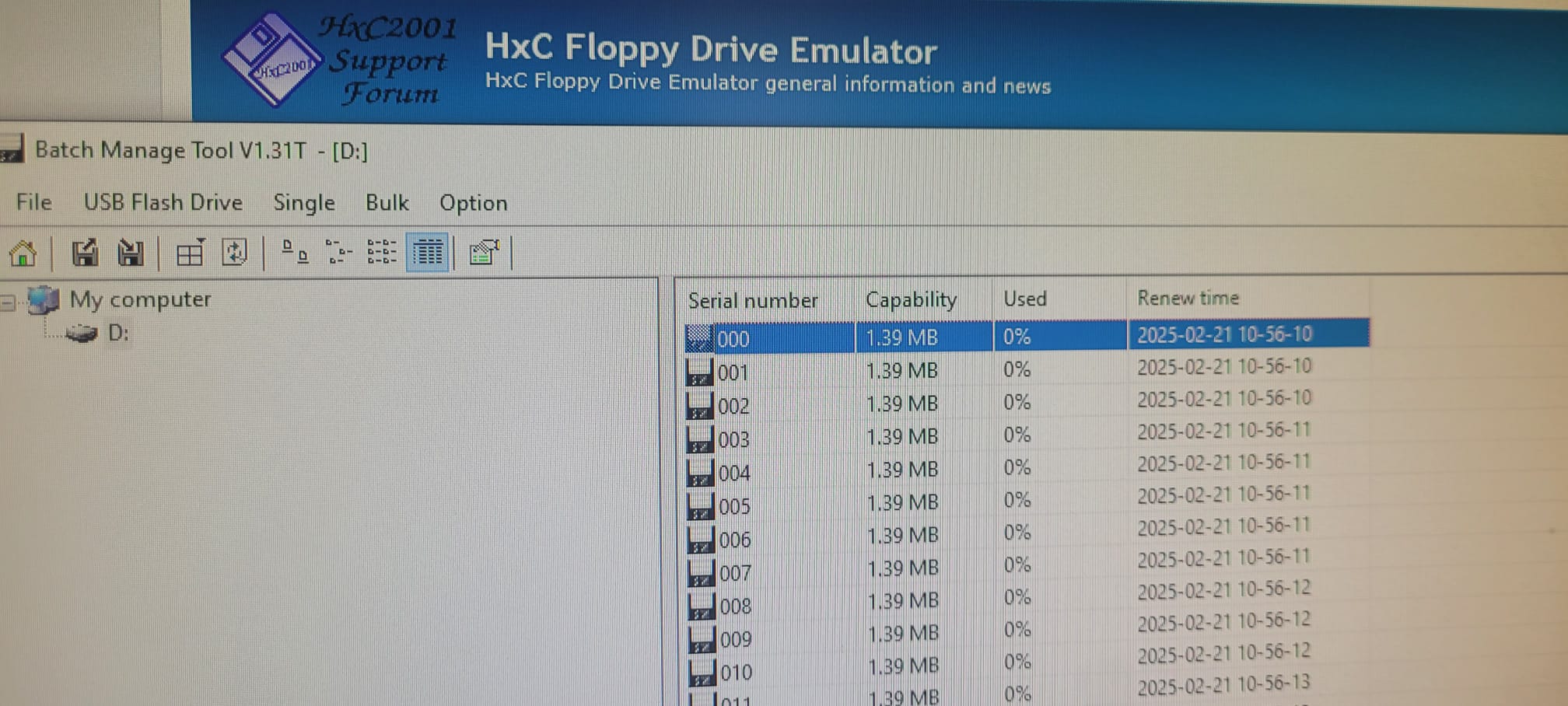

I Use the Batch Manage Tool 1.3 to Format the USB Stick, now I see there 100 Disks, so I will put the PCG Files, or KFS,KMP Files on this Disks, but it not works.

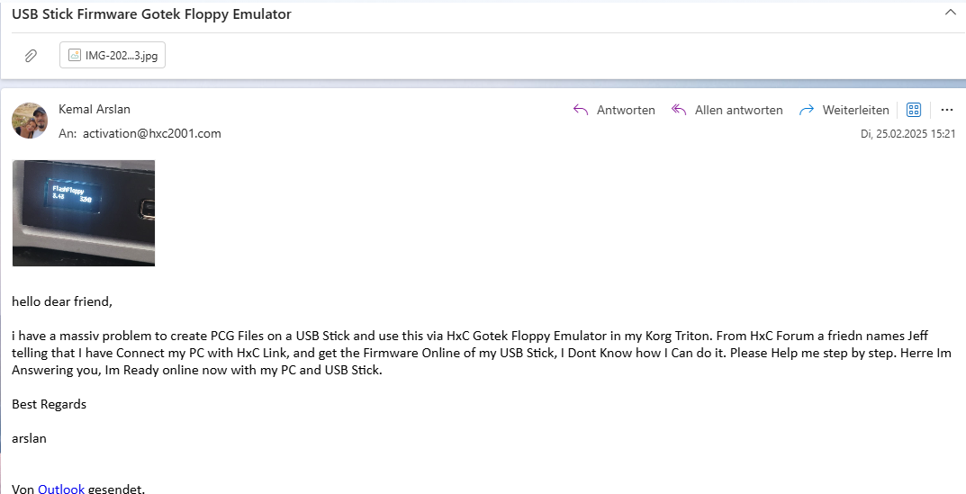

So I do Writing an email , See Screenshot down, I hope it works, I never seen a Option to get the Firmware Online by this Link that you sending me, there is many drivers but not Online Services. I Hope it works, im wairing of answer of my email and let you know whats happen.

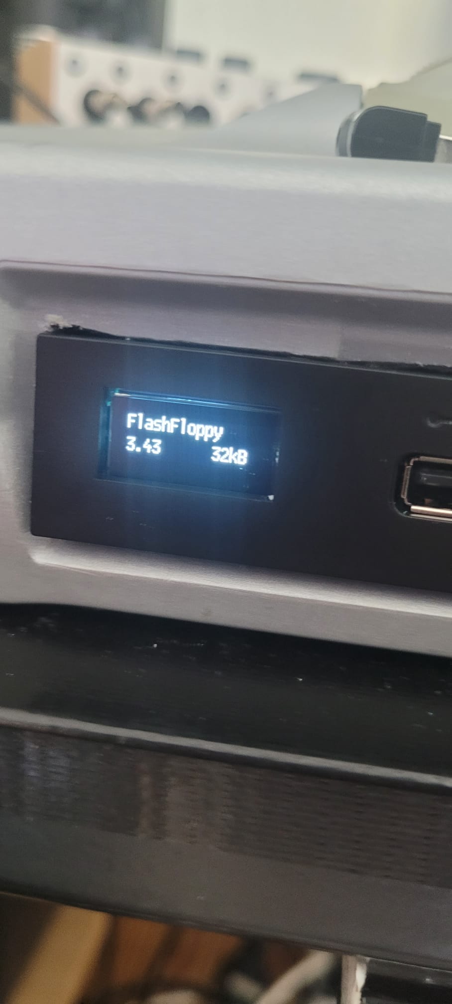

The USB Floppy Emulator with display and 2 Buttuns and LED that Im Buy by Ebay for 41 Euro was an Hxc Gotek QD Emulator, so it was with Firmware about QD, its Mean Quck Disk, so for my Korg Trito i have to use 2HD Firmware and not Quick disk, that was my Mistake!
So Jeff has see it on the Pics from me, that i have sending him, the display shows end of the Firmware QD , so Quick Disk. Jeff tells me step by step howe I have to flash the EMU with right Firmawre from HxC USB Gotek , so we done! But it not works first.

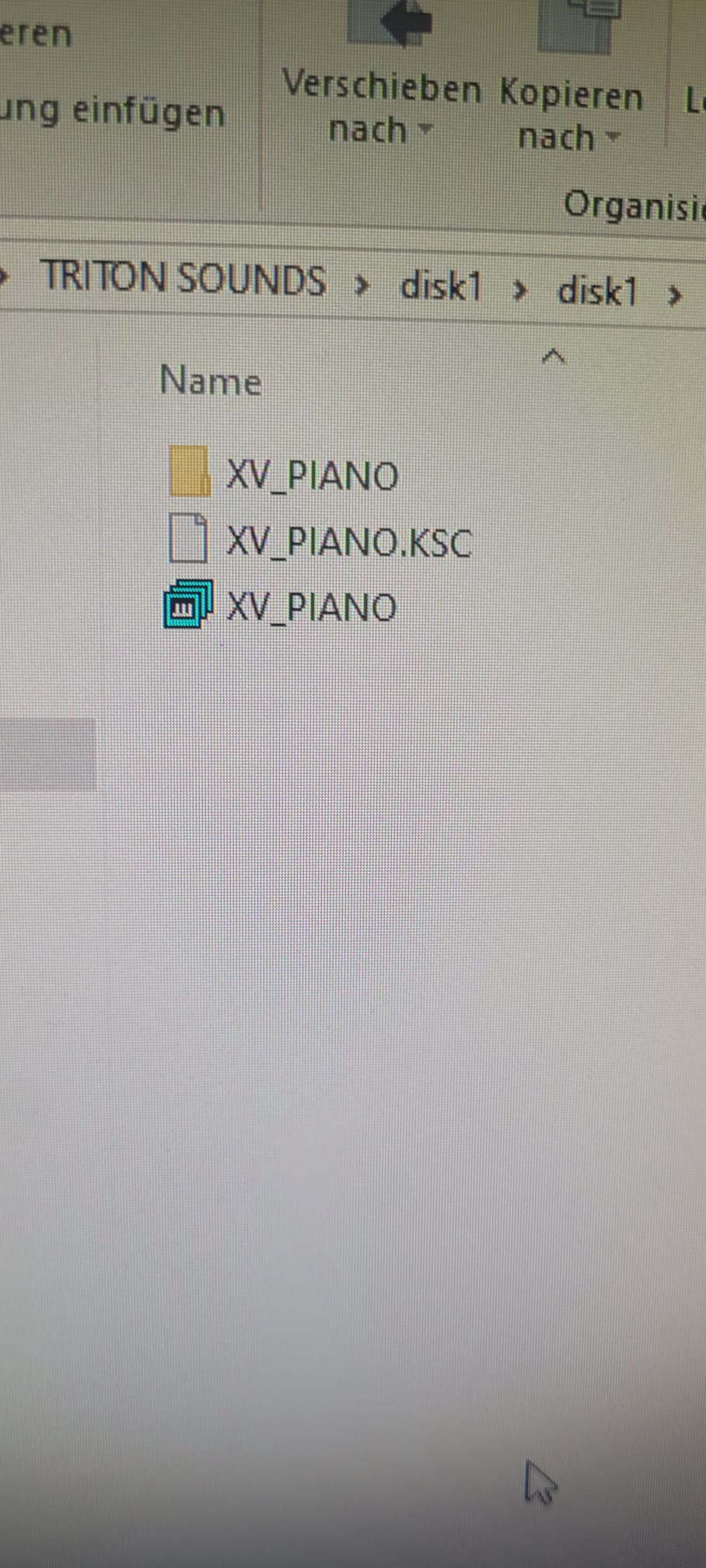

I selected in the PCG File Folders only the PCG Data, that was wrong, I put all the Folder completely in the empthy arena and close. so its works :D :D :D :D
