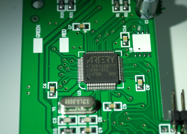

The STMicroelectronics STM32F105 MCU was replaced by Artery MCUs : AT32F415RCT7, AT32F415CBT7,...
These MCUs are "mostly" compatible with the previously used STM part but there is an important difference : The RAM size.
While the STM32F105 offers 64KB of RAM, these Artery parts have only 32KB of RAM.
Others points :
- The AT32F415RCT7 is a 64 pins device. This Gotek PCB version and the pins assignment are the same as the STM version.

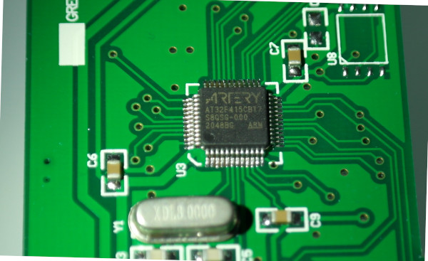

- The AT32F415CBT7 is a 48 pins device. Some headers was removed and the pins assignment is different.

-> Remap some pins for the 48 pins MCU version.

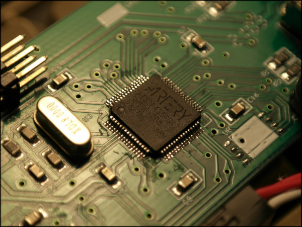

Finally a good news : The AT32F435 Gotek is now available with a lot more memory (and MHz) :D :

- The AT32F435RGT7 firmware and bootloader is done. Still some server stuff to update. EDIT 8 August 2022 : DONE !

EDIT 4 October 2021: New QFN32 Gotek ! : viewtopic.php?p=24126#p24126
EDIT 3 August 2022: New AT32F435 Gotek ! : viewtopic.php?p=24859#p24859

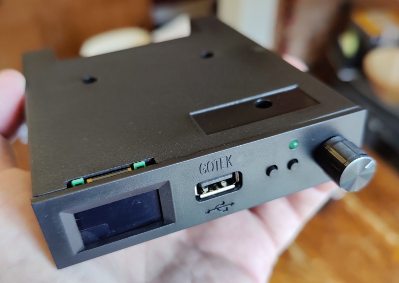

Re: New "Artery" Goteks : Current HxC firmware support status
Here is the new Gotek with the OLED and Rotary. (SFR1M44-U100LQD)
sofakng wrote: Sun Jun 27, 2021 8:47 pm That looks really nice, but I'm still not a big fan of the large rotary encoder.
Has anybody used smaller encoders or other alternatives? (maybe just adding a third button for eject?)
I am not too. These rotary can be "dangerous" with some usages since images can be changed by accident very easily.
