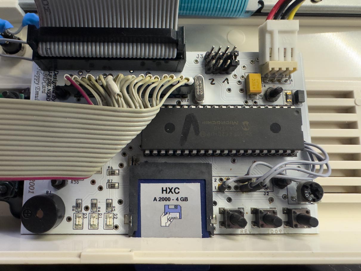

I see another floppy disk drive on your pictures. Is it connected to the ribbon ?
Re: HxC issues with firmware versions greater than 1.8.2.40
Yes, there is a disk drive, and yes, it is or was configured as DF1 and DF2 (switchable, hence the wires on the pins at the HxC). But during the test, it wasn’t connected. I just tested everything on the Amiga 1200, and I observed exactly the same behavior of the HxC with the updates. That system doesn’t have a disk drive, and the HxC is connected by itself.

Today I took out my Amiga 500, which has an older HXC installed (I think it's from 2014). I installed the latest software on it, and it worked immediately. So I removed the HXC and tested it in the A2000, and it also works there with the latest version. So it seems the issue lies with the two HXC units I bought together last year... The old one is also an REV C but looks different (older design?)
- IMG_8160.jpg (143.59 KiB) Viewed 59545 times
Thanks for the feedback. This is very interesting.HiJacker wrote: Wed Jun 04, 2025 5:15 pm Today I took out my Amiga 500, which has an older HXC installed (I think it's from 2014). I installed the latest software on it, and it worked immediately. So I removed the HXC and tested it in the A2000, and it also works there with the latest version. So it seems the issue lies with the two HXC units I bought together last year... The old one is also an REV C but looks different (older design?)
I don't have you this new exact variant, i will contact Lotharek to see if i can get one. Anyway i have an idea, I will provide you a new firmware to test.
