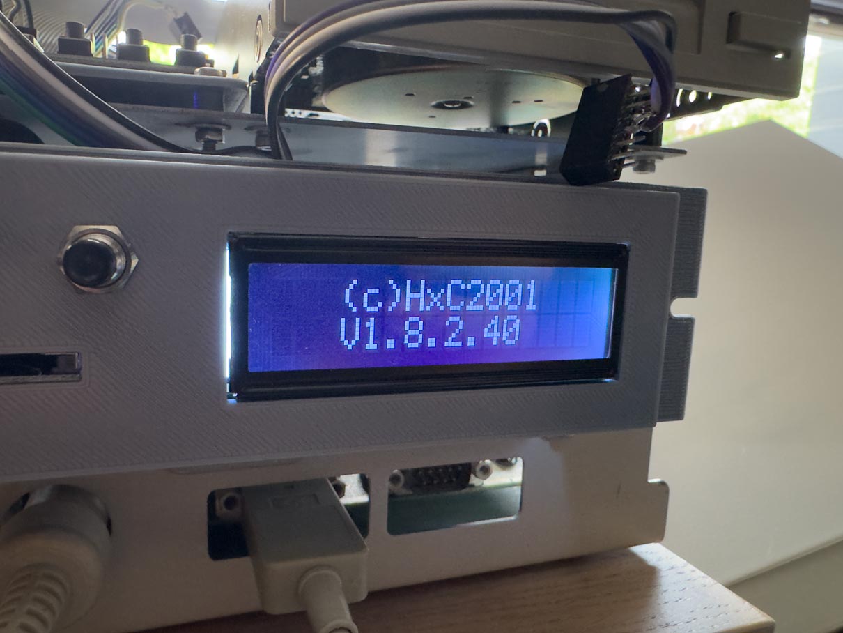

I have installed two HxC Rev C in an Amiga 2000 and an Amiga 1200. I would like to use the latest firmware to take advantage of the new features. Unfortunately, after updating, neither of them works correctly anymore. Depending on the version, it either no longer loads HFE files or reports read errors or that the disk is not a DOS disk.
With the latest firmware, it briefly loads the HFE files but then stops and displays that no disk is inserted in the drive. Only version 1.8.2.40 works flawlessly (also again after downgrade). The CFG file is also correct (regardless of whether I select AUTO or Amiga interface Mode). The HFE files are fine as well and were recreated from ADF files using the latest software.

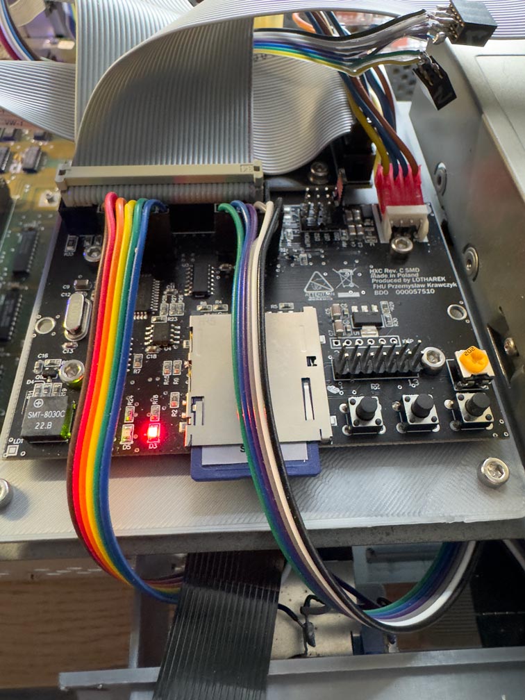

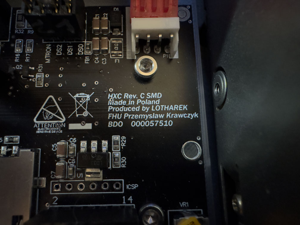

Which HxC have you exactly ? Can you post a picture ?
Are you currently trying it on the Amiga 2000 or 1200 ?
HiJacker
Posts: 14
Joined: Mon Jul 28, 2014 6:59 pm
Re: HxC issues with firmware versions greater than 1.8.2.40
Post by HiJacker »
Here you can see a picture of one of my two HXCs. Both are identical. One of them is used in an Amiga 2000, the other in an Amiga 1200. Both have the same problem with the newer firmwares...

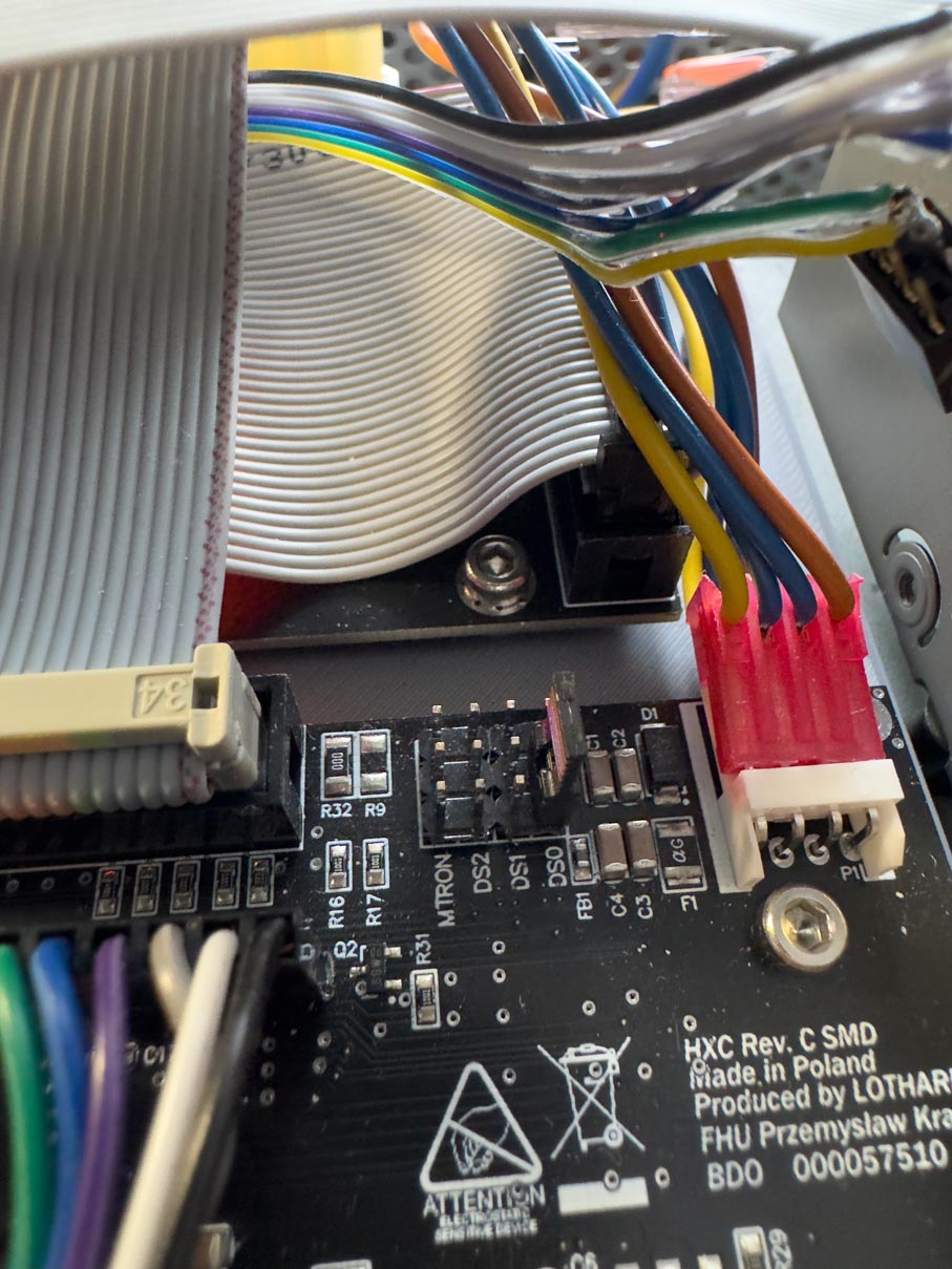

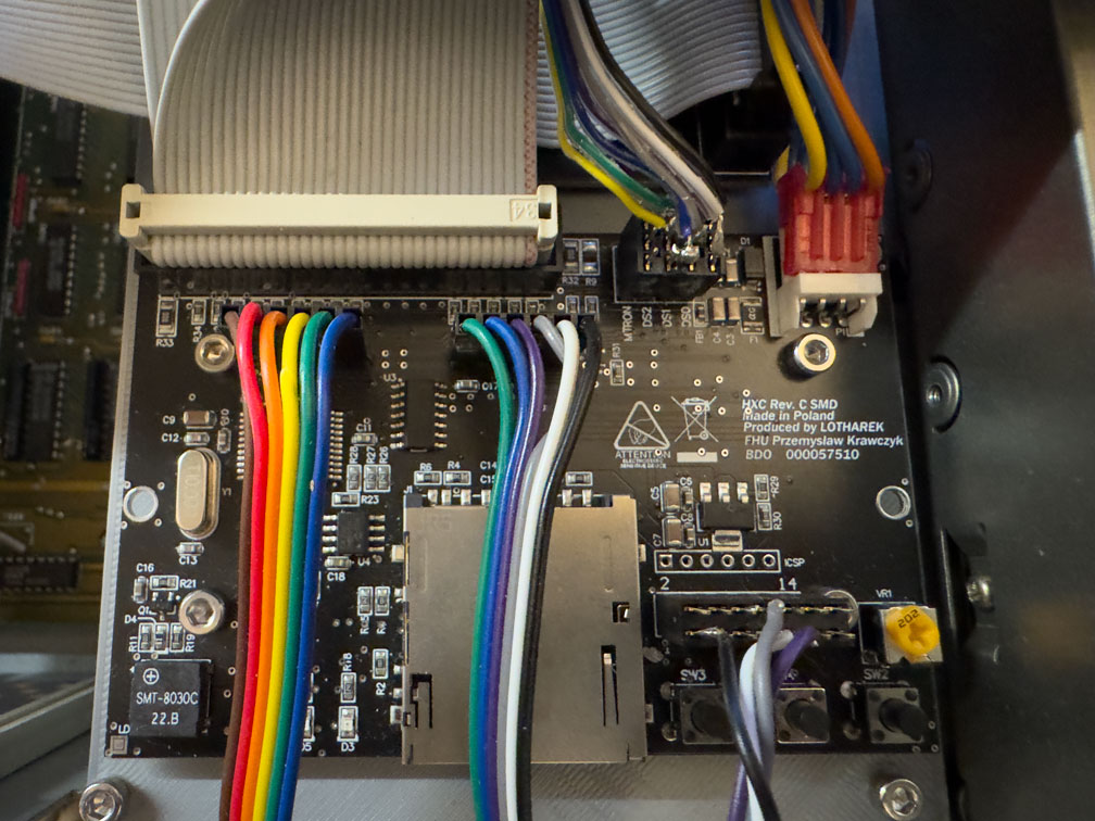

Can you explain me what you have soldered on the jumper block ? Can you disconnect this and retry with just a normal jumper on ID0-A ?
HiJacker
Posts: 14
Post by HiJacker »
I soldered a switch there. But that was actually the first thing I had removed. For testing, I of course used the HXC without the connectors and only with jumpers. Unfortunately, that's not the issue. I also suspected the floppy cable, but since I tested it on two different Amigas (2000 and 1200) with different cables, I’ve basically ruled that out as well. Especially since the old firmware versions work. Something must have changed starting with firmware 1.8.6 that’s causing the problem...
