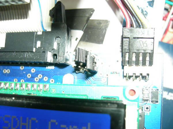

Please show me the jumpers setting.
Re: Cannot write and format in drive B:
in picture
I'm set drive B:(I'm call second drive) is boot drive and in PC see It's drive A:
and set drive A:(I'm call first drive)is drive B:in PC.
Then after boot I'm goto format program if I run this program from second drive I can format fine first drive in v 1.6.0.0
but can not format both A: and B: in v 1.7.1.2
That mean first drive can format and second drive cannot format in v 1.6.0.0
second time for update the image sometime can format first drive.
- DSCN9528.jpg (96.92 KiB) Viewed 18026 times

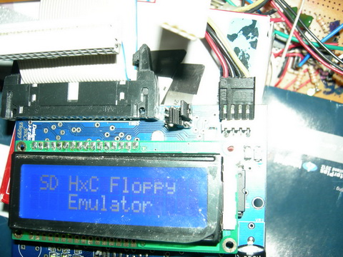

in this picture
It's my first process I'm boot program in drive A:
and cannot format drive B:(v1.6.0.0)
- DSCN9530.jpg (110.07 KiB) Viewed 18026 times
