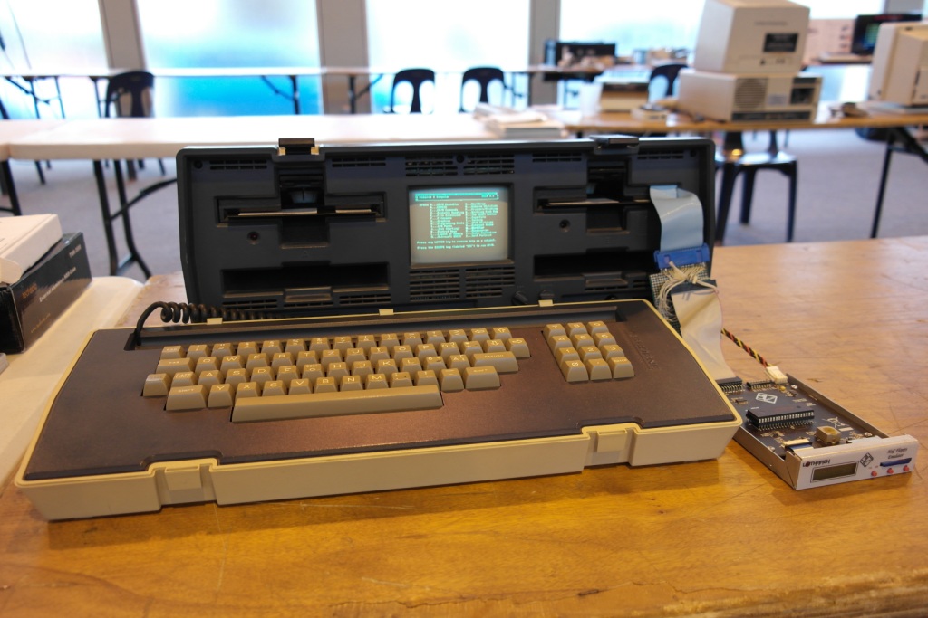

guenner
Joined: Tue Sep 08, 2015 9:25 am
Re: osborne 1
Post by guenner »
This post is old but the right topic ;)
Is there anyone who can explain how I am able to read a disk with an Osborne 1? (SD)
In my documentation I found this facts:
Osborne 1 Format (102kByte)
SSSD 40Tracks, 10 Sectors a 256Byte
Standard FM
or
204k
SSDD 40 Tracks, 5 Sectors a 1024Byte
MFM
I only get errors if I try to boot or read from a selfmade HFE-file (made it from a .td0 with the batch converter)
Thomas
(I own the Lotharek SD-Card-Drive)
Re: osborne 1
You may need to activate the double step support. This can be done into the embedded menu on the emulator (remove the sd, press select).
Re: osborne 1
Support directly done on the guenner's Osborne 1 at the Classic Computing 2015 :) .
So to make it works, just don't connect the SIDE signals. For some reasons this signals coming from the Osborne is switching randomly. Since this machine seems to support only single-sided drive, don't connect this signal is not an issue.
(Note : Double step setting is NOT needed with this machine)
guenner
Re: osborne 1
Post by guenner »
I'm really happy about my working Osborne with the HXC Emulator.
Very many thanks to Jeff's work yesterday and of course the last years! This is really important support for our community.
Thomas
