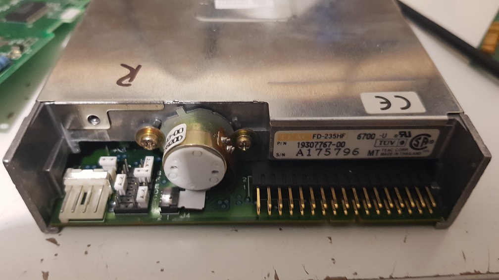

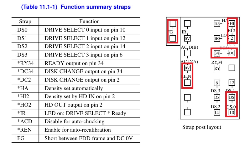

The 3.5" Drive is an Akai FD235HF A700. It is fed via an Akai FC-1. The jumpers on the FD235HF suggest that it is set for Drive 0 on line 10, Change Disk on pin 34. Density Input on Pin 2. "Key In"?
There is also one other jumper that is set for "Enable for Auto-calibration".
For the life if me, I can't seem to get this to even show signs of life. Always getting a disk not ready error.

I'd like to correct the Topic. It is a TEAC FD235HF 6700 FDD, being controlled by a TEAC FC1. The jumpers on the HDD as as per the image, and the FC1 appears to be set with the "H" jumper only.
I've tried a number of combinations in the User Defined section of HXC "P2 = Density", "P34 = Disk Change 1". I assume disk change 1 is the same as DS0 jumper setting on the gotek.

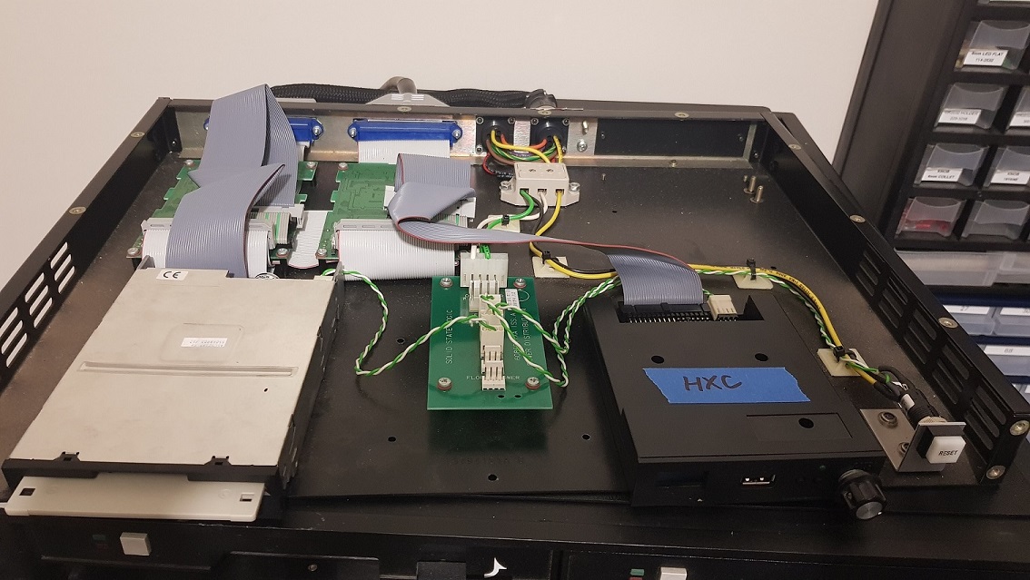

Thanks for the reply.

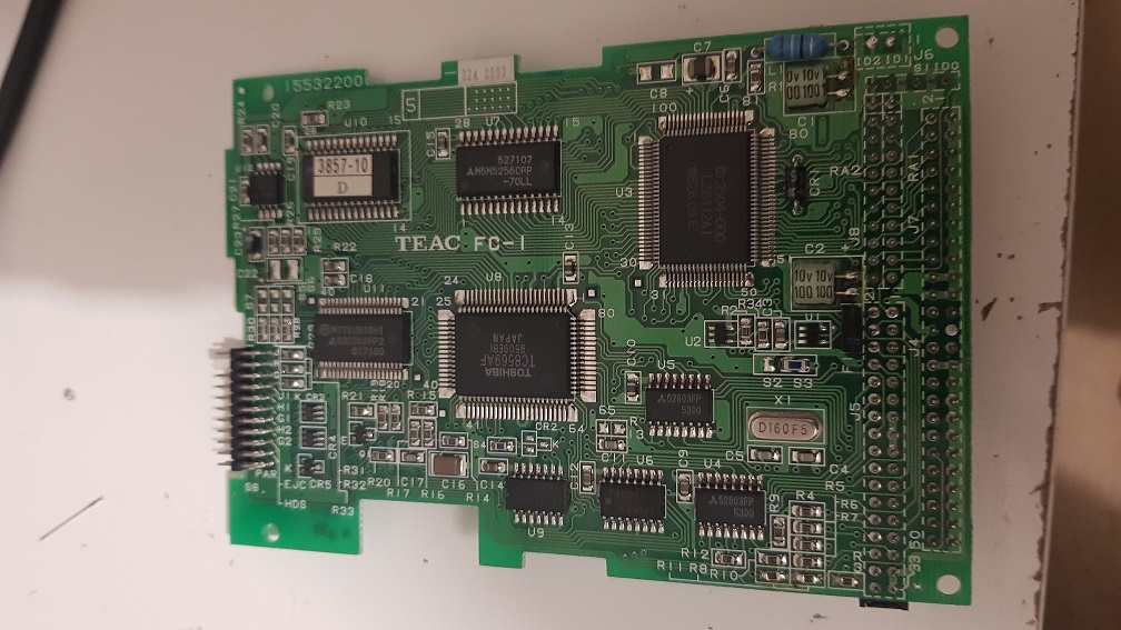

Here are some photos. It comes in to the FC1 via a 50 way SCSI cable.
There are two FC1 boards. The one on the left is set to ID 2, and the right is ID 1.
Both FDD are set to DS0 on line 10.
The way is works is that the drive on the left is the program disk which loads first. Then the drive on the right is the data drive.
Anthony.

Ok then i have a question : Are your sure that the FC-1 board is powered when the Gotek is connected ?
The SD HxC and Gotek HxC are compatible with the FC-1, but you probably need to modify the floppy ribbon between the FC1 board and the emulator, since this is the floppy drive who is powering the FC-1 board. You need to provide a +5V voltage to the FC-1 board (pins/wires 7,9 and 11)
By default the pins/wire 7, 9 and 11 are connected to the ground on the Gotek.
Can you check if the FC-1 is powered / detected ?

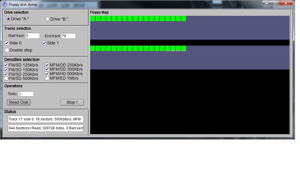

Yes the disks are HD and DOS compatible.
To be sure I imported an existing data disk into HXC (see below)
MFM HD 500kbps 80 Tracks.
I then saved as a .hfe file, so it should load straight away.
The access LED lights up, but can't be read.
Anthony.
