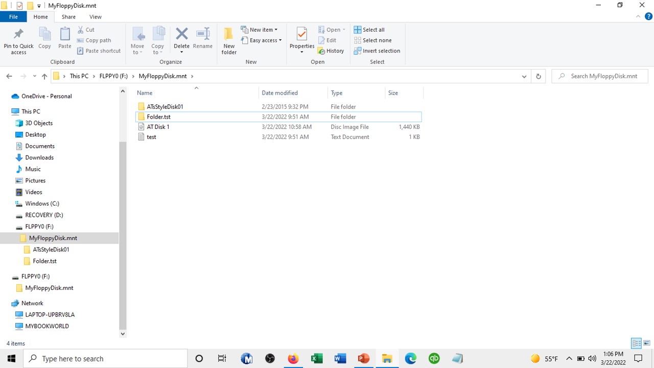

Hi I have tried to follow on line instructions for creating usb stick for image less mode. Attached is picture of the usb directory. On the gotek oled display I can read the folder and file names that are under the myfloppydisk.mnt but can only load style files from the At Disk1 image file onto the Roland AT80S organ. I cannot read same style files that are contained within the ATsytledisk01 folder. I am sure I am doing something wrong when creating USB stick but have not been able to figure it out. Any suggestions is helpful. I was wondering if anyone is selling premade usb sticks that would have partions set up and then we would only need to transfer our files to them. Just occured to me is a gotek with flash floppy firmware working same as one with Hcx firmware. maybe that is a reason why not working as I would hope
thanks
Steve
thanks
Steve

See my post of 12-06-22. Style files will load, but there is no need to put them into a "folder" on the flash drive. Each individual floppy disk as supplied by the organs' manufacturers have several files on them in the disk's root. The organ will list all the files automatically.stevehdj wrote: Tue Mar 22, 2022 7:14 pm Hi I have tried to follow on line instructions for creating usb stick for image less mode. Attached is picture of the usb directory. On the gotek oled display I can read the folder and file names that are under the myfloppydisk.mnt but can only load style files from the At Disk1 image file onto the Roland AT80S organ. I cannot read same style files that are contained within the ATsytledisk01 folder. I am sure I am doing something wrong when creating USB stick but have not been able to figure it out. Any suggestions is helpful. I was wondering if anyone is selling premade usb sticks that would have partions set up and then we would only need to transfer our files to them. Just occured to me is a gotek with flash floppy firmware working same as one with Hcx firmware. maybe that is a reason why not working as I would hope
thanks
Steve
For example, you have 30 songs [10 Rock n Roll] and [5 Classical] and [15 Jazz]. Each group has a virtual floppy. You have 57 Registrations [12 Theatre & Pipe Organ] and [24 Orchestral] and [5 Latin] and [16 String] etc etc. That would be 7 virtual floppies in total. Each time you select one of them, the organ will list the contents from which you will make a selection from the touch screen. Further, you can format, the virtual floppies using the organ's disk utilities. The organ does not support directories or sub-directories which would be pretty worthless anyway.
Hope this helps
