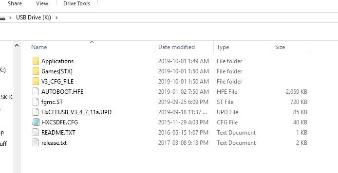

Attached is the root dir- the UPD was removed after I did the update.. Hope I did it right.

So that directory is what I have minus the UPD..

Re: everything there.. just Nor
Where did you take this CFG file exactly ? It doesn't have a normal size...
Please use the one in the firmware archive :
(the indexed version !)

Sorry Jeff, I would have sworn I took everything out of that archive.
You were correct it was the cfg.
I used the Autoboot config, now I am at the menu. All seems to be fine.

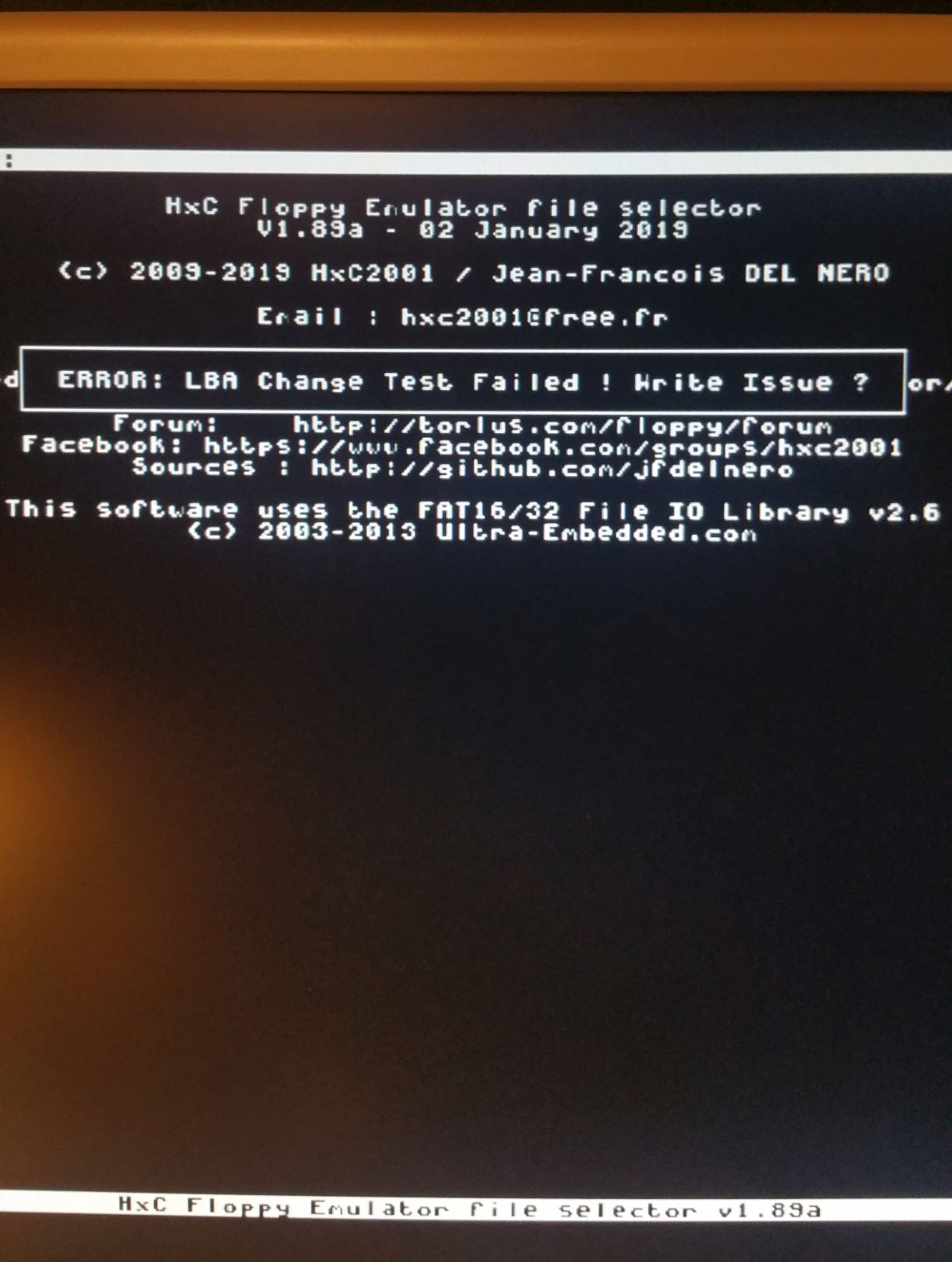

Is this normal - each time I take the USB stick out.. use it in a windows 10 machine (I am just being specific.. its always the one I put it in) then try and reboot it in HxC.. I get this.. I reboot a 2nd time.. np.
James
Same issue with cold boots ?
