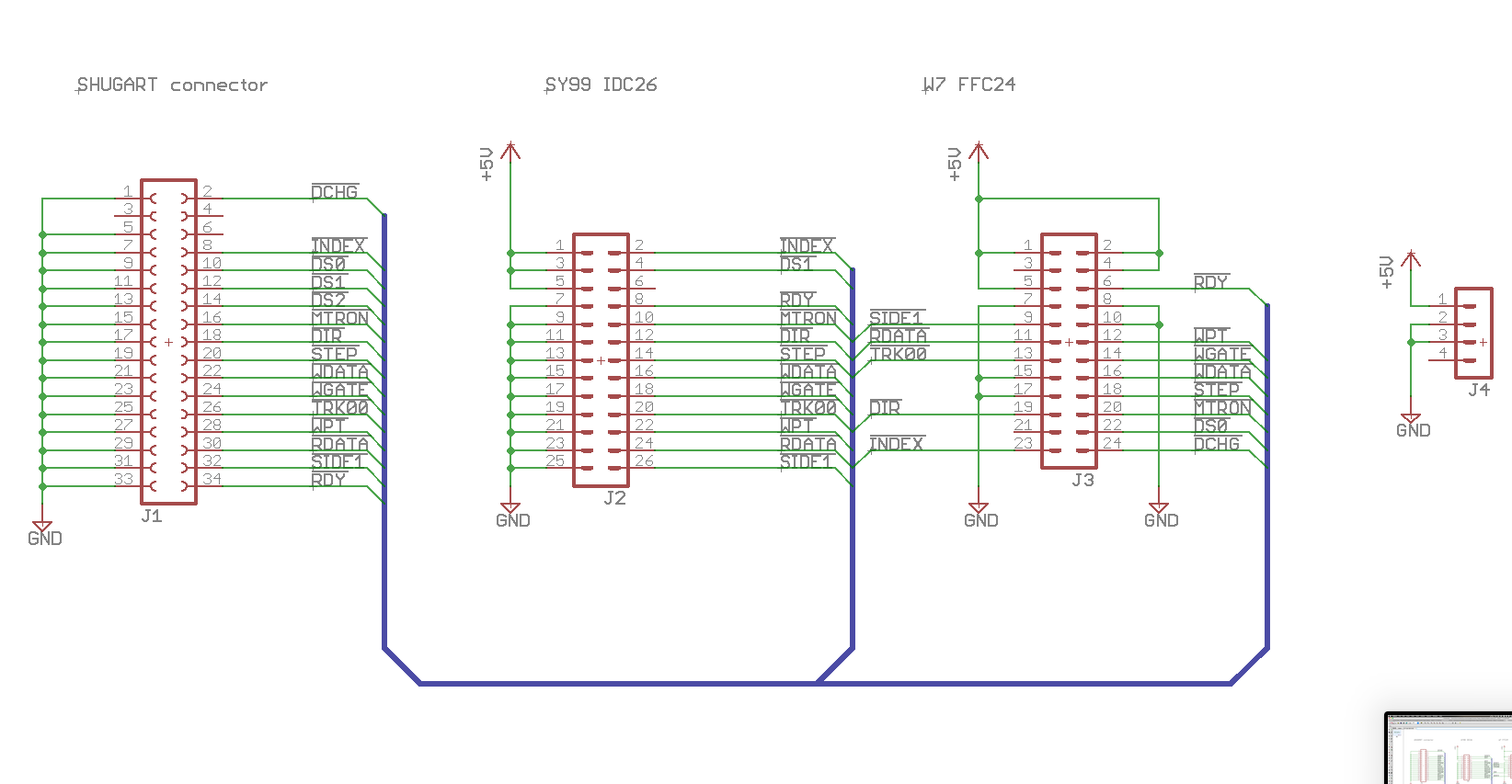

I'm working on getting a HxC flashed Gotek drive to work in a Yamaha W7. I've updated to the latest beta software (3.1.34.2).
I've made an adapter board from the 24-pin FFC cable to 34 pin IDC (schematic attached). I can read and write disks, however there are two issues:
-cannot format disks (stuck at 00%)
-cannot switch disks unless it is changed on the Gotek then the whole machine is power cycled.
I believe that the issue is related to the Disk Change command. In factory test mode, neither the disk change nor the format tests work. I've seen a few solutions on the Yamaha forums (using READY for the Disk Change command, and then using Motor On for Ready), but this didn't work for the Gotek. From what I've read, the W7 uses MSX floppy drives, however setting the second menu to MSX (instead of generic Shugart) didn't help.
I suppose this is a workable situation since both reading and writing is working, but it presents issues with spanned disks (not sure if the W7 uses them, but the SY85 and other Yamaha equipment does)

The adapter board was designed to accommodate both the MSX-type connector and the 26 pin IDC of the SY99 (and presumably the SY77). I tried it on the SY99, and had exactly the same problem (could read and write, but not format). Interestingly the SY99 only worked when parameters 00 and 01 on the HxC Gotek were set to 'auto'. It didn't like the Generic Shugart mode.
The connections for the 26 pin part of the adapter are identical to the official Yamaha floppy adapter board that they made for the SY99.
