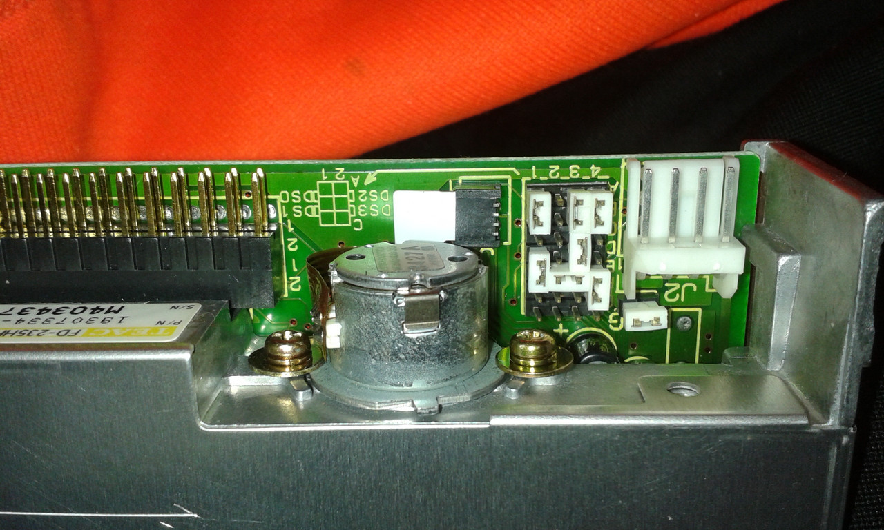

thats the broken floppy drive i want to replace with the emulator
Imagefotos hochladen verlinken

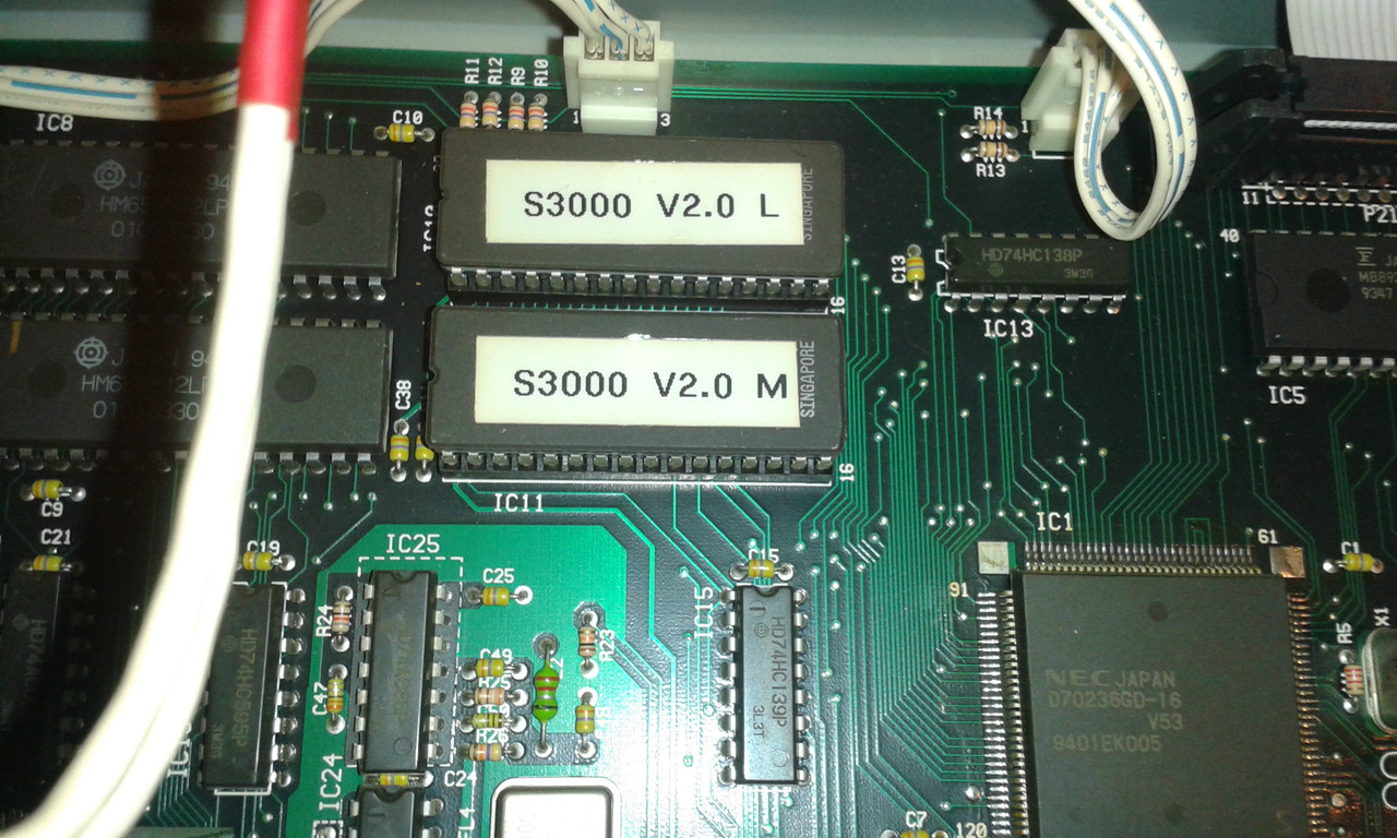

no the OS 2.0 floppy disk is not needed to boot it up......the unit has OS 2.0 EPROMS....

i found out AKAI S2800, S3000, S3200 Sampler have the same eproms
