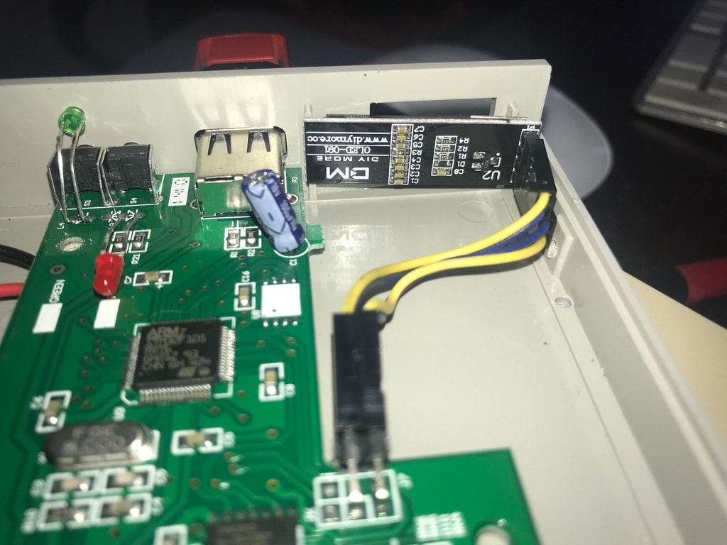

Hi, I correctly installed an OLED in my Gotek using latest HxC firmware.
The ONLY way the display will work is just after initiating the upgrade process (on + hold both buttons) and then everything works fine, I can see the image files, select through them and even go in settings in the OLED. Resets work fine too.
The issue is when I turn off the Amiga and back on again the Gotek will work BUT the OLED will not work at all unless I initiate the update again.
What is wrong ?
Re: Problem with OLED and Gotek
This is an issue with the screen reset signal. The R-C circuit of this screen is probably too slow.
Can you send me a picture of this OLED screen (pcb side) ?
I will add a latency setting in the firmware to deal with these slow screens, probably late in the afternoon.

There you go

ok will check this this evening. Can you check that your setting still saved after a reset ?
about the screen did you know if your model have the pull resistors on the i2c lines ?
Yes it saves the settings even after reset. Just to let you know the new fw's you made have other issues, the last one you sent me autoboot.hfe works but the other disk images do not and the one before not even autoboot.hfe loads. The other fw's 3.0.33.12a which are in the file section as normal load autoboot and disk images fine
I dont know about pull resistors
