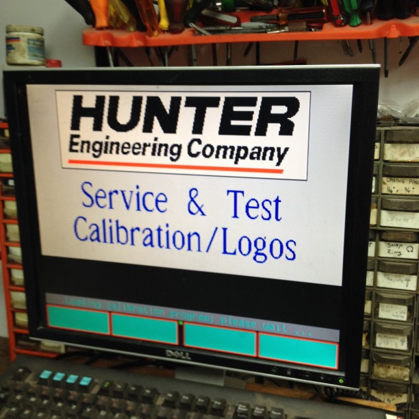

i am dropping this here...
found a way to achieve all i wanted.
thanks.
thanks.
