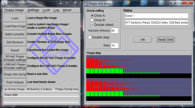

Re: Support for Netstal synergy - injection molding.
Try to make an image with the hxc software.
follow the procedure page 14:
https://hxc2001.com/download/floppy_driv ... al_ENG.pdf

I did a test.
Jack

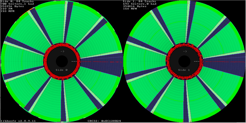

Here is the disk geometry :
not a problem for the hxc emulator.
