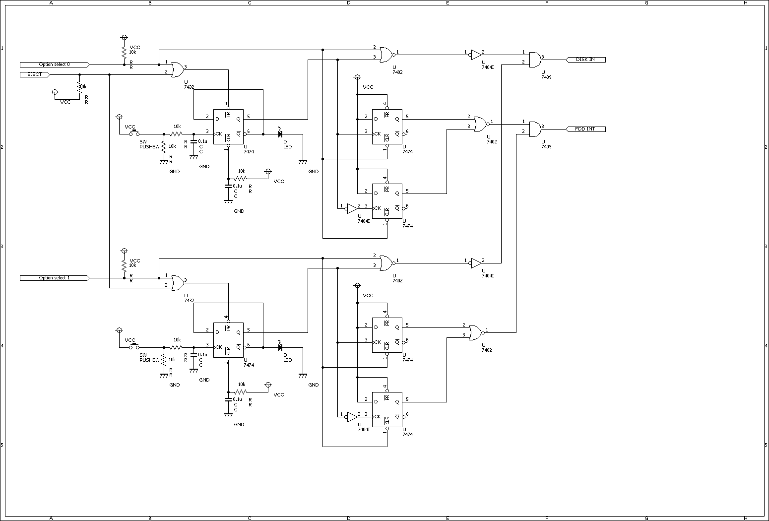

Hi, most of X68000 games will not properly work with HxC floppy emulator due the lack of some X68000 proprietary FDD signals.I get same behaviour of you, reading will stop at track 4.Sometimes you have to wait some minutes and then track reading will go on but this is not valid for all games.
To workaround this problem I used a simply circuit made by kitahei88 (credits to him) with emulates two of the X68000 signals (DISK IN and FDD INT), see picture attached.It works pretty well on all games, the only game which gave me trouble is Valis II (neither kitahei88 understood why).If you look at the circuit there are two switches and two led for each FDD drives.When you press the switch you communicate to machine host that a disk has been inserted generating a DISK IN output signal (after this you can mount images on HxC) so the led will stay ON until an interrupt is generated by the host (the auto-eject X68000 feature).It's not immediate but it works, I implemented this on my CompactXVI along with HxC SD floppy emulator and I'm happy of it (though a custom FDD cable was required)

caius wrote: Fri Nov 21, 2014 4:34 pm Hi, most of X68000 games will not properly work with HxC floppy emulator due the lack of some X68000 proprietary FDD signals.I get same behaviour of you, reading will stop at track 4.Sometimes you have to wait some minutes and then track reading will go on but this is not valid for all games.
Ciao Caius,
sorry to revive this old thread, but i made a pcb with the kitahei88's schematics, but it work only with few games to me, and for single floppy is event worst than without insert and fd_int handling. Can you share some picture or gerbers from your one?
