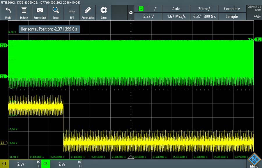

Looking at the Gotek read, it does not have a pause after the Ready is asserted. Are there too many read "bits/bumps"?
Do you transmit data once the Ready signal is asserted?

AMSynths wrote: Thu Aug 29, 2019 5:27 pm Looking at the Gotek read, it does not have a pause after the Ready is asserted. Are there too many read "bits/bumps"?
On the last images i post it should have a blank. Maybe it is wrongly placed ? Can you dezoom ? was 20ms/per division, now it's 200us/div

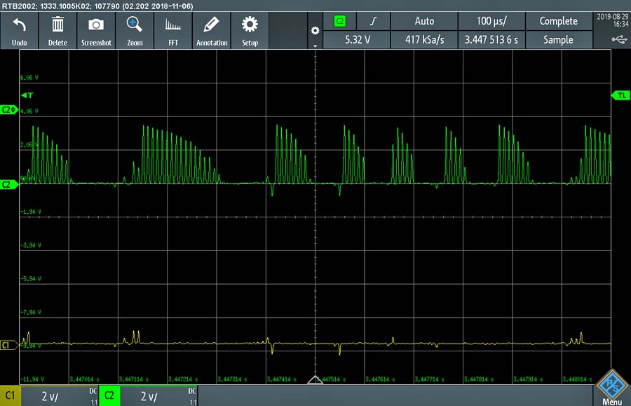

The Real QD is not sending a constant stream of data with the same number of bumps...and does not look like the "predictable" Gotek read pattern
See trace...

AMSynths wrote: Thu Aug 29, 2019 5:38 pm The Real QD is not sending a constant stream of data with the same number of bumps...and does not like like the Gotek read
See trace...
Sure , this region is unformatted so the data are "random". I can add this in the image since the firmware support weak bits emulation but i am not sure if this the right way to fix the issue.

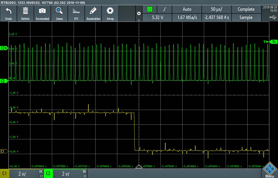

Take a look...there is no pause after Ready assert and the data looks very different.
Looks like the quick disk chip cannot sync to the data stream as its immediately throwing an error

AMSynths wrote: Thu Aug 29, 2019 5:52 pm Take a look...there is no pause after Ready assert and the data looks very different.
You use 50us/div. Your screen with the blank was 20ms/div.

Here we go - Gotek Read at 20ms trace
Gotek - Read Cycle @ 20ms - Ready and Read Data .jpg (104.24 KiB) Viewed 25782 times
Re: 2.8" QD Disk Emulation
AMSynths wrote: Thu Aug 29, 2019 6:09 pm Here we go - Gotek Read at 20ms trace
With the "blanked_track_start.zip" files ?
