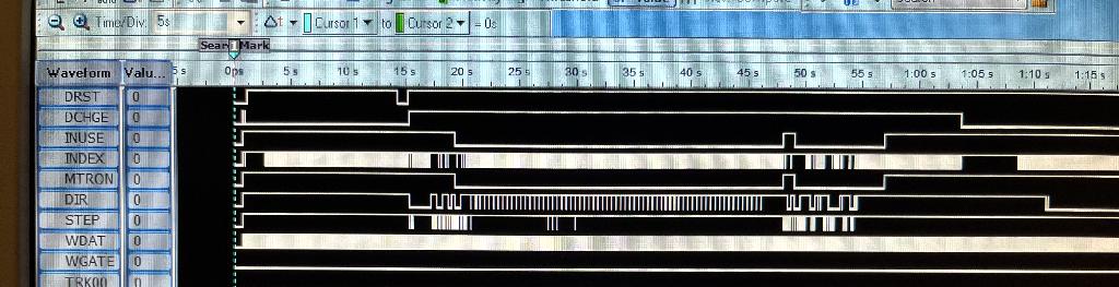

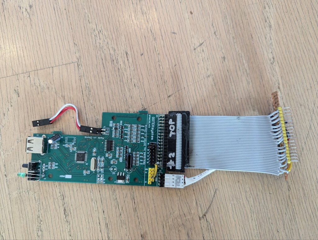

Gotek with the HxC on an HP1652B
Re: Gotek with the HxC on an HP1652B
Ok that is in work!
What particular action do you want me to do (to verify your theory). Do I need to put the Logic Analyzer trace up again?
I completed the update to the new version. I don't see any difference from my perspective. Attached is the Logic Analyzer plot and the settings I used, just in case they are useful. Compression produced some moire effects.
Ok, i will fix the firmware for the QFN32 gotek !
So i have updated the instructions and the firmware for the AT2 QFN32 Goteks :
https://hxc2001.com/download/floppy_dri ... P_1652B.7z
Regenerate the firmware with these settings :
Go to this page :
Set :
- "Non gated mode"
- "Floppy Interface mode" to "Advanced pins configuration"
- "Advanced pin 2 configuration" to "nDiskChanged (mode 1 : DSKCHG Clear -> Step only)"
- "Advanced pin 34 configuration" to "nReady"
- Enable Reset DC (Diskchange) input signal (pin PA14)
- Bitrate override : "500kbit/s"
Then go down to "Build order" to generate the new firmware.
Once upd file received by email, you can update your gotek with this firmware.
Update procedure :
https://hxc2001.com/docs/gotek-floppy-e ... pdate.html

I had trouble getting the disk change signal to work on my SFRKC30.AT3 Gotek, because I connected the disk change reset signal to JK, like for the SFRKC30.AT2, since the PCB looked very much like the AT2. But then I noticed it has a 48-pin Artery, and I checked and it has the PA14 pin exposed in exactly the same location as in the SFRC922. I thought I'd share this with anybody interested.
I did the rewiring of the Gotek connector by soldering header pins to a strip board, and then soldering a segment of ribbon cable to it. One hint if you go that route: if you use cheap header pins, the plastic around the pins does not adhere well to the pins themselves, and so the main thing holding the pins is the copper traces on the strip board. I ended up potting the soldered side of the header pins in JB Weld after I had one pin rip the strip board.
- gotek.jpg (203.5 KiB) Viewed 15574 times
