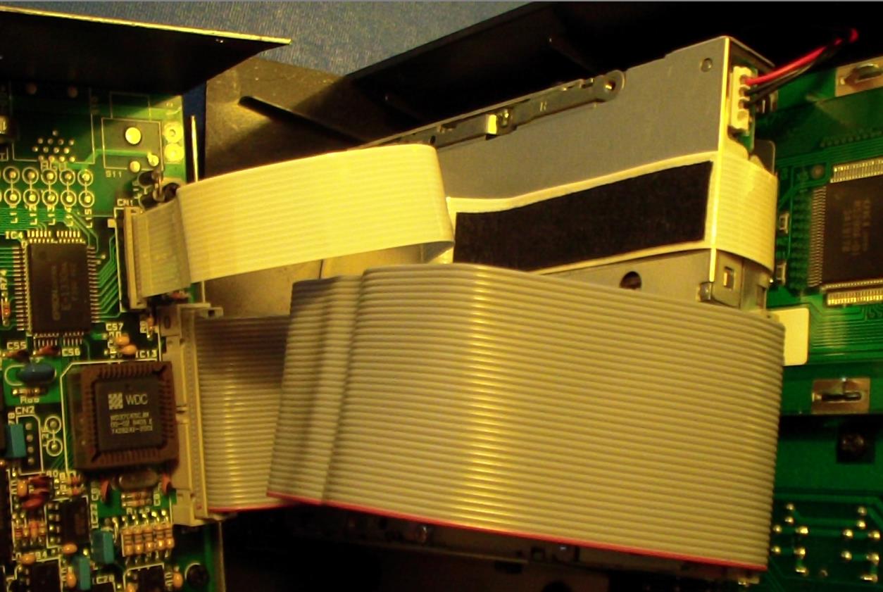

need pictures. and why your are using the autoboot.hfe ?

You need pictures from what? The connection is a short 34pin flat cable 1:1 not twisted. The WX-Expander with original floppy loads at power on all files on a inserted disk automatic. Now i try to emulate this automatic load function with the HxC-Floppy. If this is possible with an other type of hfe file, i have no need of an autoboot.hfe. At power on, it is not possible to select a file because the entire disc with all subfolders has to be read in.

To see exactly what you have done (to see connection, switch settings, power connection...)
a good picture is generaly 100x better than non-ending forum or email exchanges...
the autoboot is only for CPC, Atari and Amiga computer. No point at all with the GEM WX...
What i am missing to answer correctly :

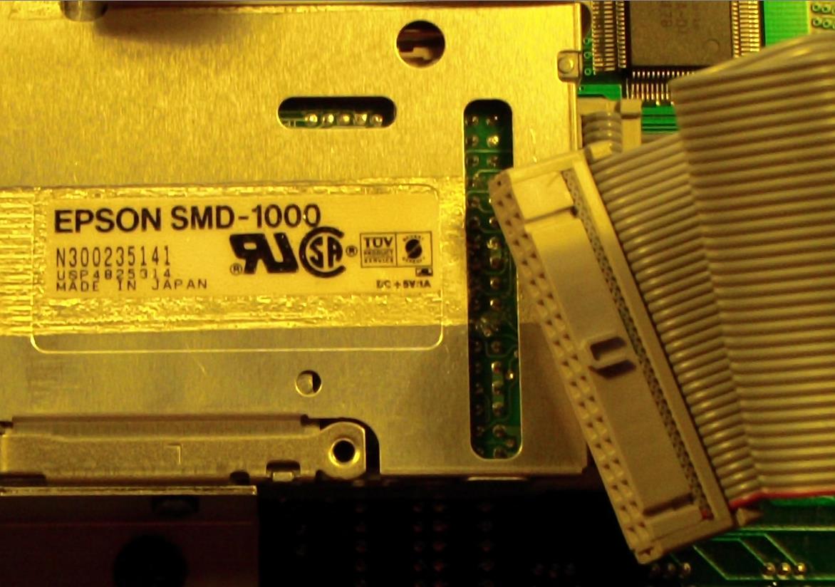

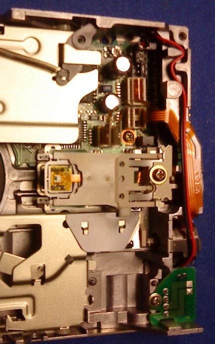

The original floppy disk drive and jumper setting (Some pictures please !)

In the moment i have only this pictures available. For jumper settings on the original floppy i have to look this evening at home.
(pictures sent by email)

Now the pictures of the original Floppy also in this forum:
The small flat cable is for the display under the floppy.
