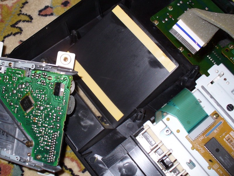

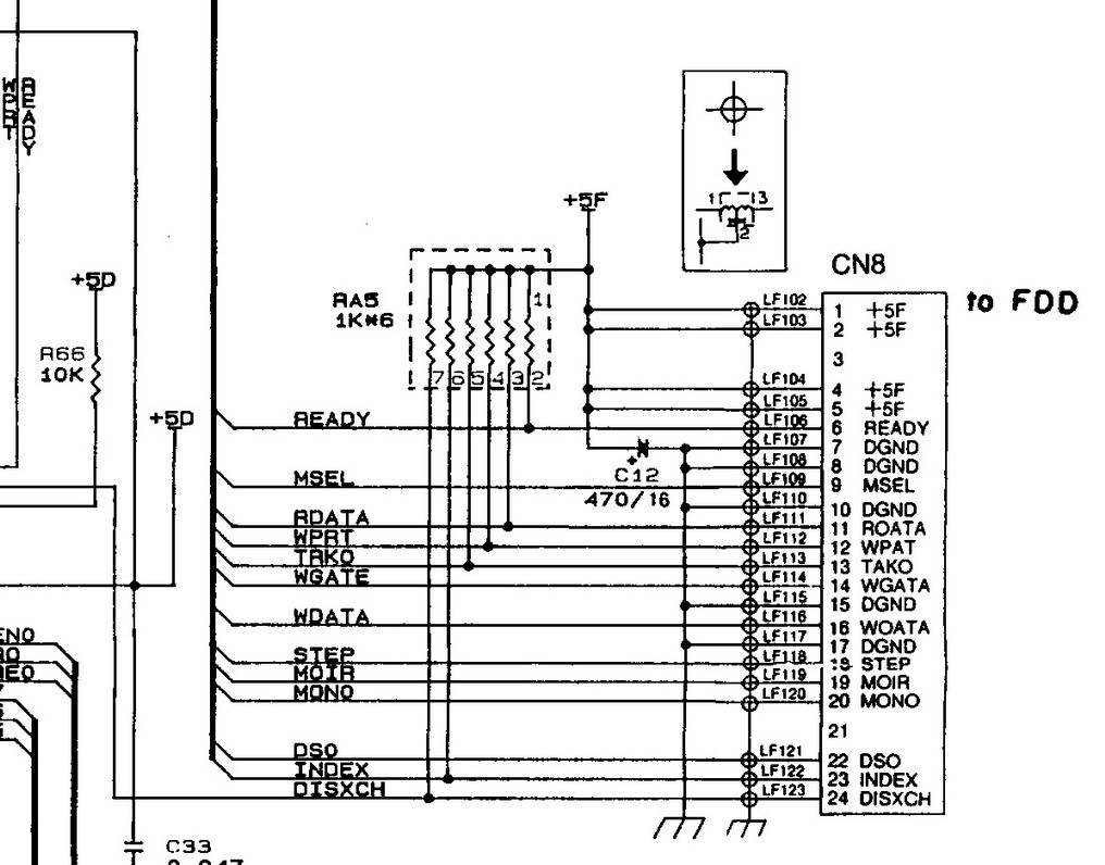

Thank you for your answer. unfortunately I can't find a flatcable converter. The Keyboard uses a 24 pin flatcable. I attached a picture. Yamaha sent me a shematics of the FDD connetctor, but I can't figure out how I can build a convertor out of it. Any help? Thank you.
PSR1700-2700_OA1 Floppyanschluss.jpg (158.8 KiB) Viewed 8853 times

Ok I am really stuck here. Can anyone help me with a adapter there? I even can't find a "24 pin flat cable connector". Are the parts not produced anymore ?
Any ideas if there is a way to fit the HxC in a PSR 2700?
Thank you very much.
