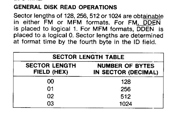

my WD1793 supports 128 bytes/sector either in FM and MFM Mode.
It would be nice, if you can insert the support for 128 bytes/sector in MFM.
Frank
