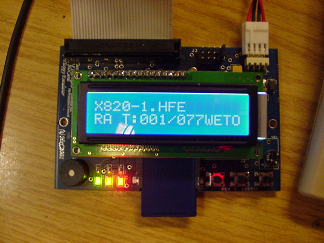

i have a problem when writing to the diskimage over the SD-Card Emulator to an image of a 77Track_SS_SD Disk.
There are 26 sectors of 128 Byte on each track.
The reading goes fine, but when i write to it, i get the Display "WET" as shown and there is no alteration in the image,
when i write 52 sectors over two tracks. Don't confuse with the "RA" in the picture. This happens by writing.
I have no further idea. :roll:

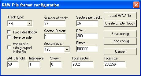

The hfe i use is like the picture attached.

This is strange because WETO means that you are trying to format the disk.
What are you doing to get this ?

If you are sure that you are not doing a format command, you must check that you are writing into the right format according to the HFE file : FM mode at 500kbits/s
There are maybe a bitrate problem.
