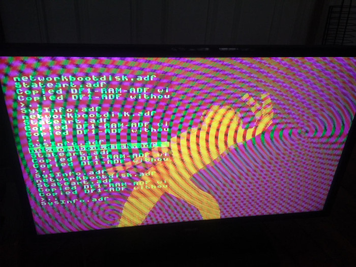

3 January 2023 : Firmware STM32/AT32 USB HxCFloppyEmulator v5.0.3.4a - Pre Release
- On screen display / OSD : AT32F435 / SFRKC30.AT4.35 Goteks compatibility added.
Online build page : https://hxc2001.com/custom_fw/

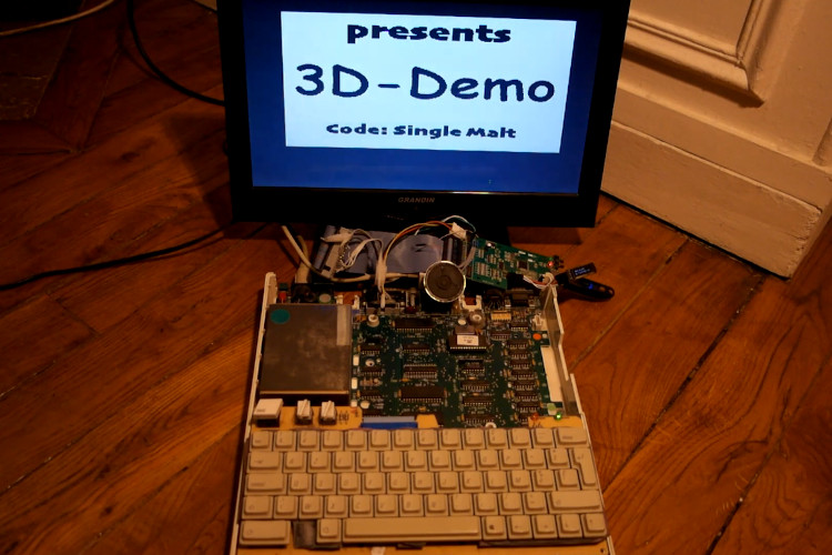

8 January 2023 : Firmware STM32/AT32 USB HxCFloppyEmulator v5.1.1.1a - Pre Release
- Apple II Support added :
Floppy interface mapping :
               Apple II floppy interface  <------------------> Gotek floppy interface
               (Int 20pins / Ext DB-19)
        PH0    (Int pin  2 / DB19 pin 11) <------------------> UART RX Pin (J4)
        PH1    (Int pin  4 / DB19 pin 12) <------------------> UART TX Pin
        PH2    (Int pin  6 / DB19 pin 13) <------------------> /DIR   (18)
        PH3    (Int pin  8 / DB19 pin 14) <------------------> /STEP  (20)
        /WREQ  (Int pin 10 / DB19 pin 15) <------------------> /WGATE (24)
        SEL    (Int pin 12 / DB19 pin 16) <------------------> /SIDE1 (32)
        /DRVEN (Int pin 14 / DB19 pin 17 or pin 9 *) <-------> /DS0   (10)
        RD     (Int pin 16 / DB19 pin 18) <------------------> /RDATA (30)
        WR     (Int pin 18 / DB19 pin 19) <------------------> /WDATA (22)
        WRPROT (Int pin 20 / DB19 pin 10) <------------------> /WPT   (28)
(*) pin 17 for the drive 1 - pin 9 for the drive 2.
- Currently supported file format : Standard HFE.
You can convert DO/PO/DSK/NIB files to HFE with the HxC Software.
- Write support not tested yet.
Demo : https://www.youtube.com/watch?v=B-pzItOAO1g
