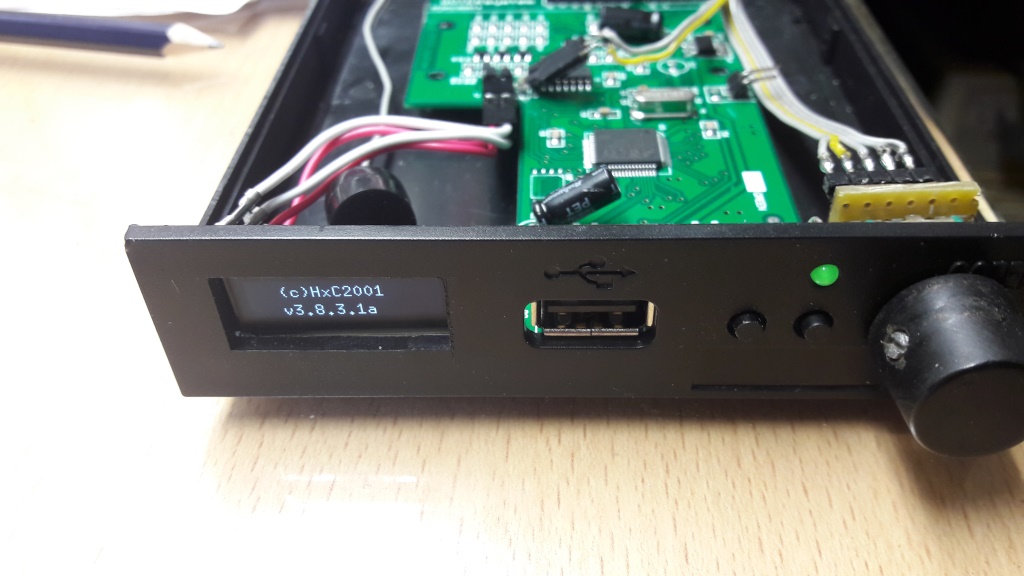

Hello, I modified a GOTEK with OLED and Rotary. Firmware is V.3.8.1.a. The pushbotton is o.k. but the rotary switch don't work.
With a FlashFloppy IMAGE work the rotary.

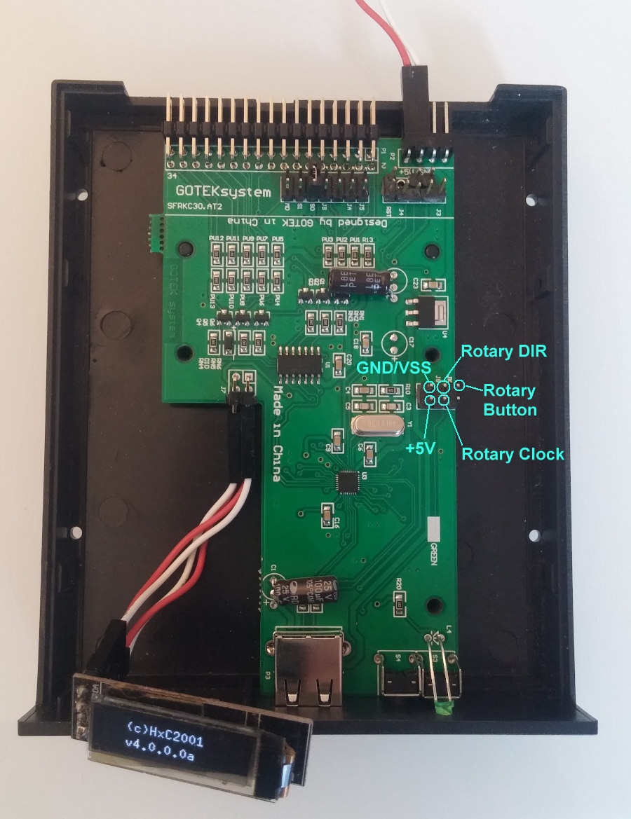

The right wiring for this model is :
viewtopic.php?f=2&t=4132

Hello,Jeff. Thanks for your quick reply.
But that's not how it works, not even the rotary switch.
I have the PCB "SFRK30AT4".

Re: Rotary do not work
d.elm wrote: Wed Dec 29, 2021 12:40 pm Hello,Jeff. Thanks for your quick reply.
Tank you
Then please use the latest 4.x.x.x firmware available in the "WIP_firmware" folder.
