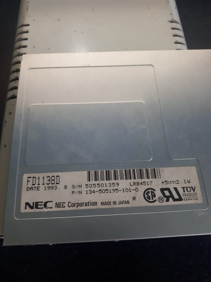

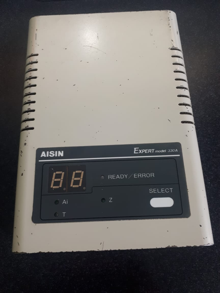

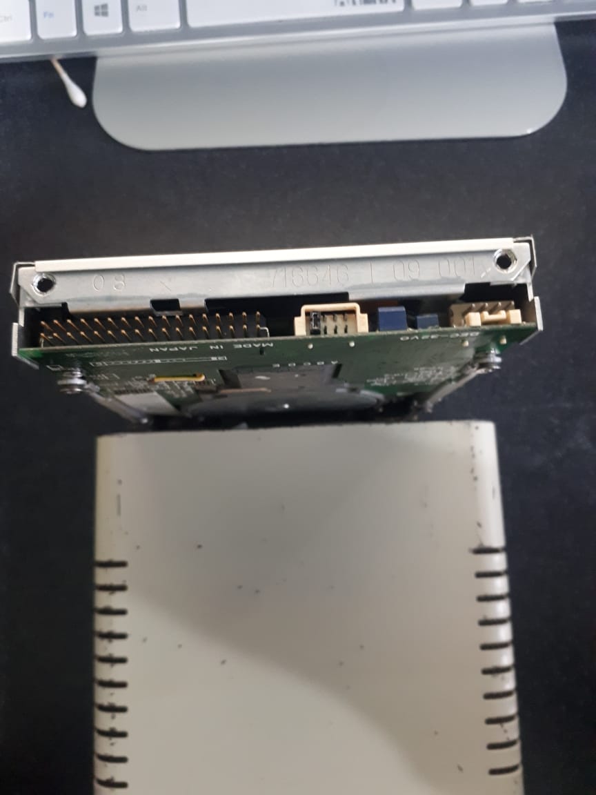

Tomorrow I get the USB ttl, and I will also buy the firmware, but I have some doubts after having read the instructions.
I understood the first process First time bootloader Flashing / Programming process. after that I didn't really understand the firmware update process.
What Firmware should I use to emulate the FD1138D, and also if I only have to connect the USB with the file corresponding to the connected equipment.
- ACM330.jpeg (56.54 KiB) Viewed 5187 times
- FD1138D.jpeg (52.8 KiB) Viewed 5187 times
- 1.jpeg (54.05 KiB) Viewed 5187 times

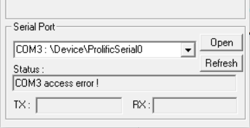

I already acquired everything I need, at the moment of flashing it gives me this error.
- puerto.png (10.54 KiB) Viewed 5169 times
Re: Emulate NEC FD1138D for embroidery machine
I switched to windows 7 and it worked without any problem.
I already installed the firmware (* .upd). I will continue with the following steps.
