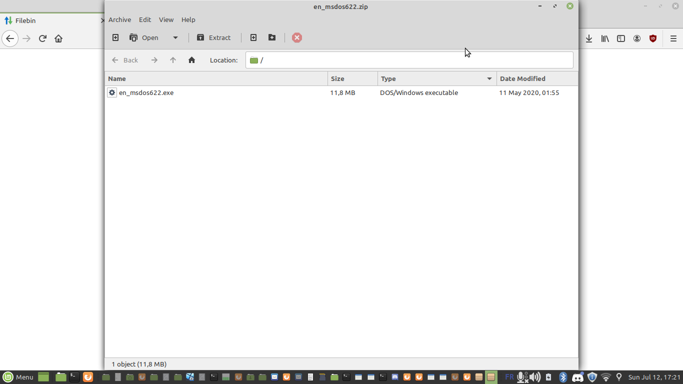

Re: Unable to boot or access floppy images
This seems to be an exe :
Screenshot at 2020-07-12 17-21-59.png (50.47 KiB) Viewed 3658 times
xohs
Posts: 10
Joined: Sat Jun 27, 2020 3:18 am
Post by xohs »
Ah yes inside the zip is a self-extracting exe as distributed from Microsoft. I extracted to a dir on my side and re-uploaded just the images.
Try this one. You should get 12UPG1.IMG, 144UPG1.IMG and so forth. I was testing with the 144UPG*.IMG files.
https://filebin.net/or8bdz6dilai5k6d
