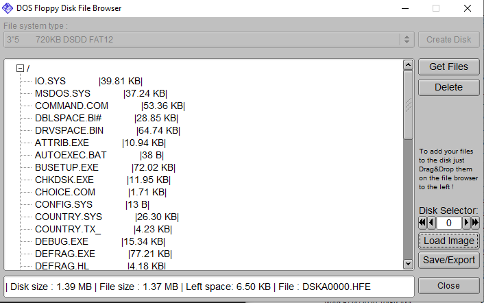

My problem is I can select my DSKA0000.HFE file but it never boots. I have multiple bootable .HFEs (converted from .IMG) that show up but won't boot. I have confirmed that the OLED shows 'disk inserted'. After booting the hard drive to Win95 and trying to access the drive, I see "Not ready reading drive A" on every disk selected. Same result with the original .IMG file instead of .HFE.

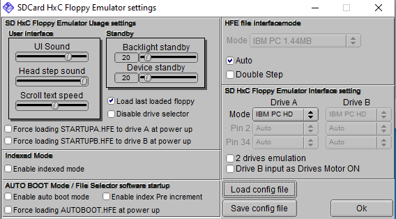

I'm thinking this is one of a few things. Either the HXCSDFE.CFG file is incorrect or my .HFE images are problematic. Any thoughts or input you can provide would be very helpful, thank you.

- Next, I removed the .upd file, copied the HXCSDFE.CFG to the root of the card (photo attached of settings)

- HXCSDFE.CFG
- SDHCCFG.PNG (33.48 KiB) Viewed 25835 times

Update -
I found this post: viewtopic.php?p=7467#p7467
You had a DOS .HFE bootable disk in there so I downloaded it and tried it out. Boots perfectly on the system, so this is telling me I am having a problem with my .HFE files.
