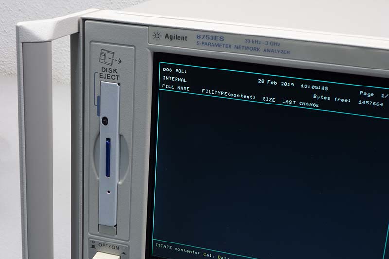

After installing the 1K pull-up resistor in R4, R8 and R9, the problem was the image I was using. I found a thread about a Tektronix oscilloscope that uses the same TEAC drive as the 8753ES and I downloaded the image used there. Now it is working great, thank you!
I am attaching the image file just in case it is of help to someone in the future. Also a picture o the finished installation. I had to drill a hole to fit he plastic piece and I sanded the border of the metal frame because it did not fit in the window the instrument has for the floppy. I also painted it, it resulted too white, but I prefer it to the black one.
It is working great now.
