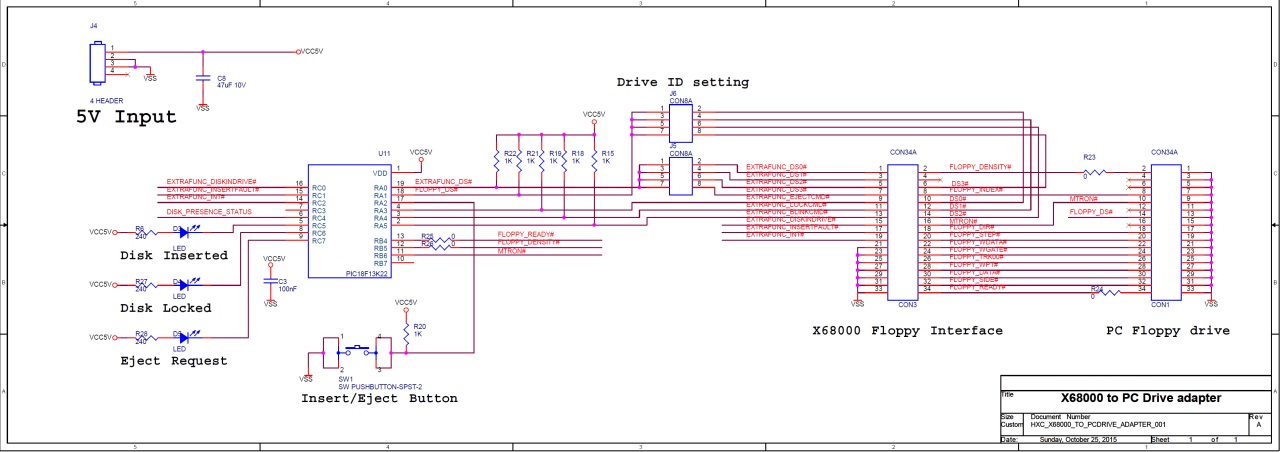

caius wrote: OK.I see you emulated all the extra X68000 signal and not only the most important (INT and DISK IN).Like other solutions also the yours will requires to activate a switch to notify the insertion/eject of a disk/disk image.
The DISK_PRESENCE_STATUS signal is an input to know if a disk is inserted into the drive or not. This will come directly from the presence detector switch of the drive. By this way, no need to push any button ;).
OK.I guess this will work also on HxC emulator which, obviously, has no mechanical switch.Will you use some signal from HxC MCU to notify the PIC about the insertion of a disk image file?
P.S.
Actually in my previous message I was referring to the 'Insert/Eject Button' I can see on your schematics.

Hi All,
I have recently got a X68000 Compact and also a Pro and trying to figure out what is required to use the HxC.
Looking through most of the posts in this forum, is this the latest schematic for the addition board required to make it work correctly?
download/file.php?id=754
Also is the PIC firmware anywhere?
I currently have the SD Card HxC is this the correct version to use with the X68000 ? or do i need the Slim SD Card HxC ( is this the new fpga version )
Any help is appreciated
Regards
Chris

Hi All,
I have wired up the HxC to my X68000 Pro to check what it does without this board and i can see some games do load okay, but others you have to wait on track 4 for it to time out waiting for the additional signals.
I know Jeff you are probably pretty busy, but can you point me in the right direction for getting the pic firmware or is there another HxC on the horizon that solves this issues with running it on an X68000 ?
Regards
Chris
Posts: 8311
Re: HxC SD floppy emulator works with X68000 CompactXVI
chris_jh123 wrote: Fri Nov 09, 2018 6:19 pm Hi All,
Regards
Chris
some switches to generate some interrupts and io state can be used as workaround.
