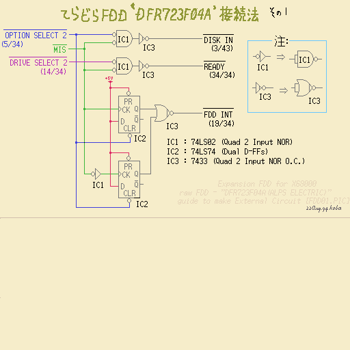

Re: HxC SD floppy emulator works with X68000 CompactXVI
BTW have you noticed this ? :
http://ohsatan2012.web.fc2.com/x68/hard/x68_fdd.html
This was done 13 years ago and seems to do the job...

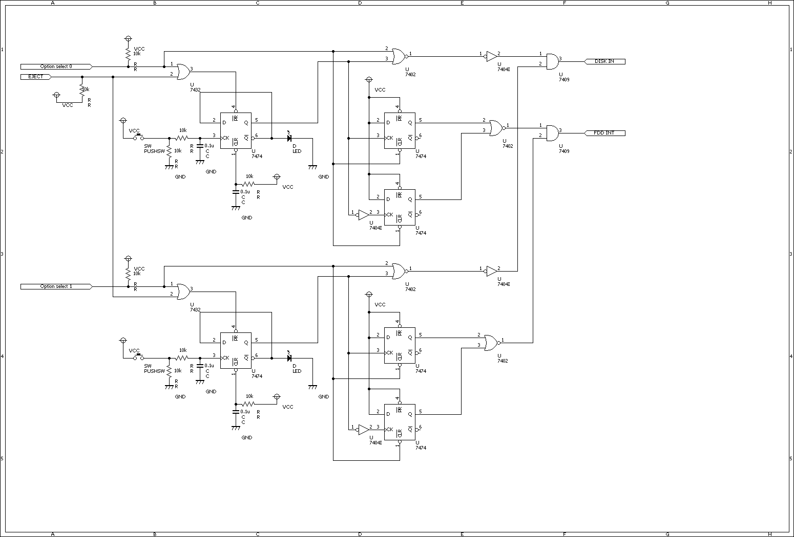

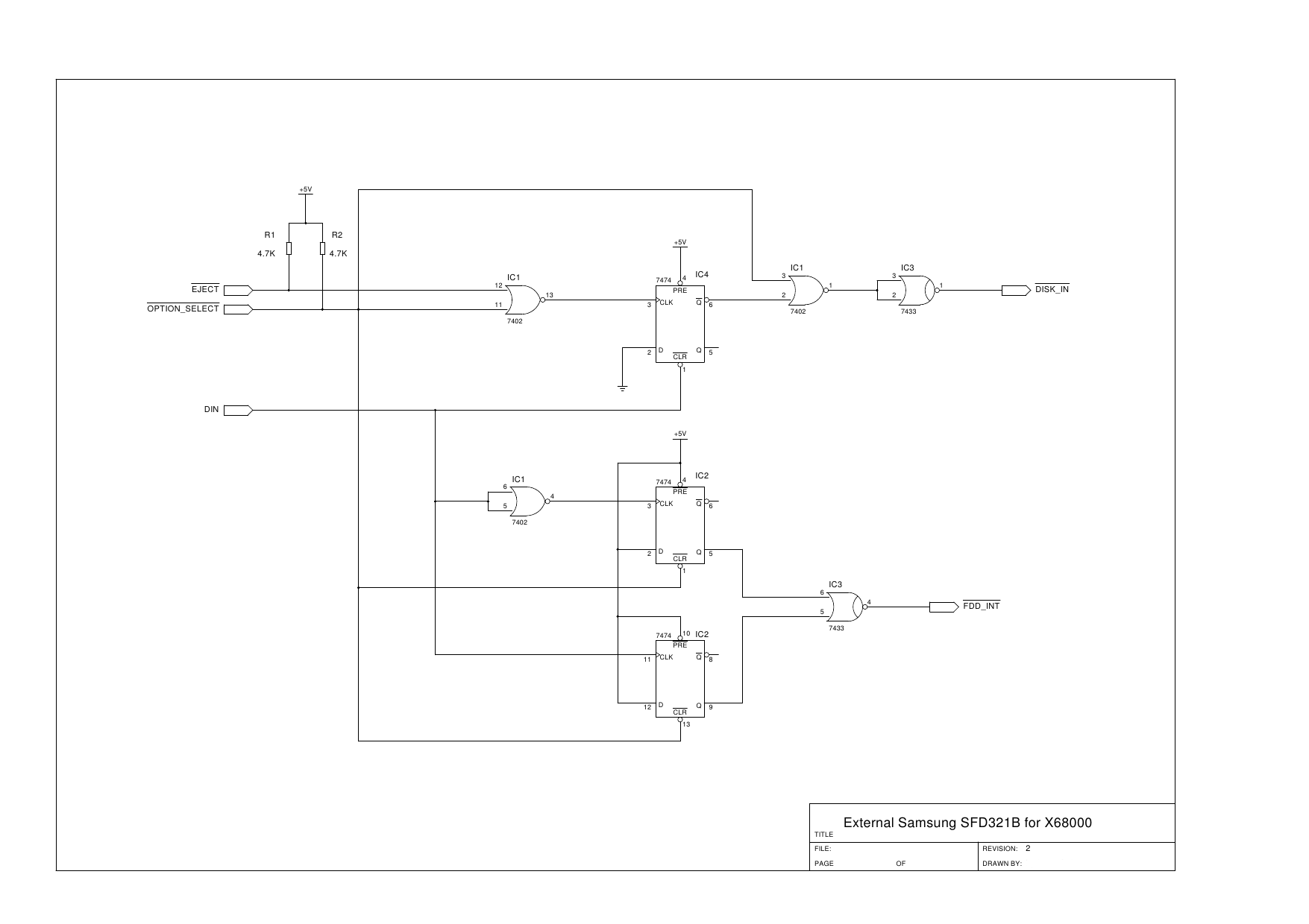

Hi Jeff and thanks for replying.No, I didn't notice this project but I see some signals are not used (like EJECT) which are needed for correct working of some X68000 software.
Then, look at the 'DISK IN' input signal to the PIN1 of the 74LS86, this is an output signal usually present on every real FDD (on a Samsung SFD-321B 3.5" FDD is called DIN, for example, on other FDD is called MIS) which confirm that a media has been inserted but I don't think your emulator is able to output a disk image mounting.Am I wrong?
I attach here some similar project I found on the net.The first two (Eject circuit(2).gif and circuit.gif) use always "DISK IN" signal from a real FDD like the one posted by you so I think they won't fit in your HxC, the third is interesting (X68kFDDemul.gif, made by Kitahei88) and according the author works well with your HxC SD floppy emulator but it's a little bit tricky, you have to push a switch to communicate to X68000 that a disk (disk image in our case) has been inserted.As you can see it uses also the EJECT X68000 signal but according the author it has some problem with some games,one of this is Valis II, I think this game would the perfect test bench for a correct development, if the X68000 extra-signals emulation will work with this game, then will work with all other ones.
- circuit.gif (8.04 KiB) Viewed 42914 times
- Eject circuit(2).gif (29.9 KiB) Viewed 42914 times
- X68kFDDemul.gif (21.53 KiB) Viewed 42914 times
