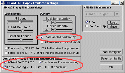

i would like to put the emulator into the amiga like this:
So the buttons are not accessable for me and I have to use the "file selector" (bootloader).
Is it possible to use a 2-disc-game?
How can i assign disc 1 into drive 0 (slot 0?) and disc 2 into drive 2 (slot 1?)?
Is there a way to save those settings that i don't have to adjust this everytime?

By activating these options you can use the hxc without button :
just eject and reinsert the sdcard to change the slot number.
and just power down and power up to boot the file manager.
https://hxc2001.com/download/floppy_driv ... anager.zip

Jeff wrote:just eject and reinsert the sdcard to change the slot number.
what is "power down" and "power up"? Switching off the Amiga???

Re: Changing discs without buttons
Yes of course.

Jeff wrote:By activating these options you can use the hxc without button :
Hi,what is UI Sound and Head Step Sound?
