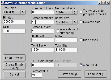

Re: SAM Coupe again
These DSK are in RAW format and should be used with the 80tracks * 2sides * 10 sectors MFM format.
You should use the RAW file function :

Re: SAM Coupe again
Post by yerzmyey »
Ah, I see.
OK then, I will be trying. :)
Thx a lot!!!!

Hmmm.
All buttons stay inactive. (Except the "Load config" and "cancel").
I have a version 1.5.2.1. It looks in a different way, than Your screenshot.

Re: SAM Coupe again
yerzmyey wrote:Hmmm.
Do You think I should get the newest one? (My HxC USB is very old, I'm afraid of some incompatibility with the newest PC software...?).
Greetzzzzzzzz,
Y
No compatibility problem with the usb hxc ;)

What is funny, with the new version, I managed to force the damn SAM to work. At least at the moment (we will see for how long).
Now I will test the method You mentioned. With RAW.
And will let You know.
Thx,
Y
yerzmyey
Posts: 28
Joined: Fri Jan 15, 2010 4:45 pm
Re: SAM Coupe again
Post by yerzmyey »
Dude, You're brilliant - everything works fine, just like You said.
THANKS A LOT. :)
