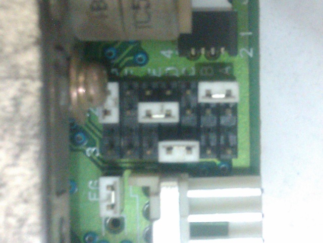

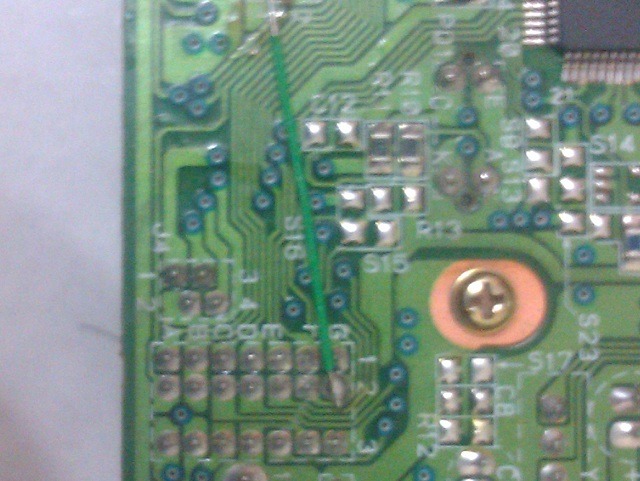

Hi
My Pcb router Machine use Sieb & Meyer system
Its Filesystem is non dos standard and use Teac FD235HF 7529 Floppy with special Jumpers
Jumper
DS0 or DS1 (Two Floppies)
RY34
HA(HS-HI)
REN
FG
Jumper
Jumper
Jump Line
it connect PIN1 to HS
Jump Line
Jump Line

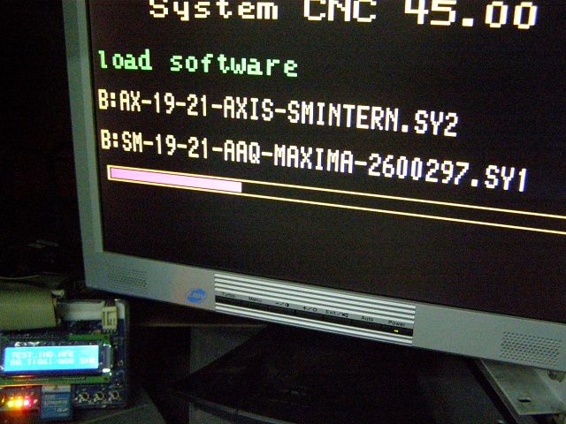

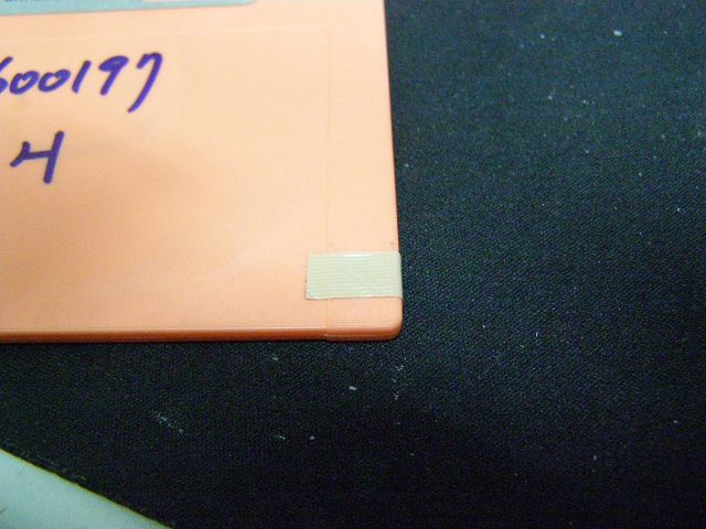

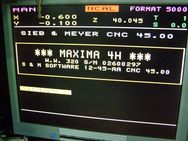

So finally it is successful. :wink:
Because I use HD disks.It should be froced to 2D for Dump

(and a small video of the CNC loading & doing something with the HxC would be very nice :wink:
