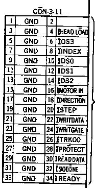

EDIT: I am still looking for the information, but I did find this interesting thing. I found the floppy pinouts for an earlier version of this system, and they seem to be SLIGHTLY different from standard shugart. Please let me know what you think. I'll get back to you when I have the specs on the format.
Floppy pinout on FM77AV
FM77AV floppy pinout.JPG (29.93 KiB) Viewed 57713 times
