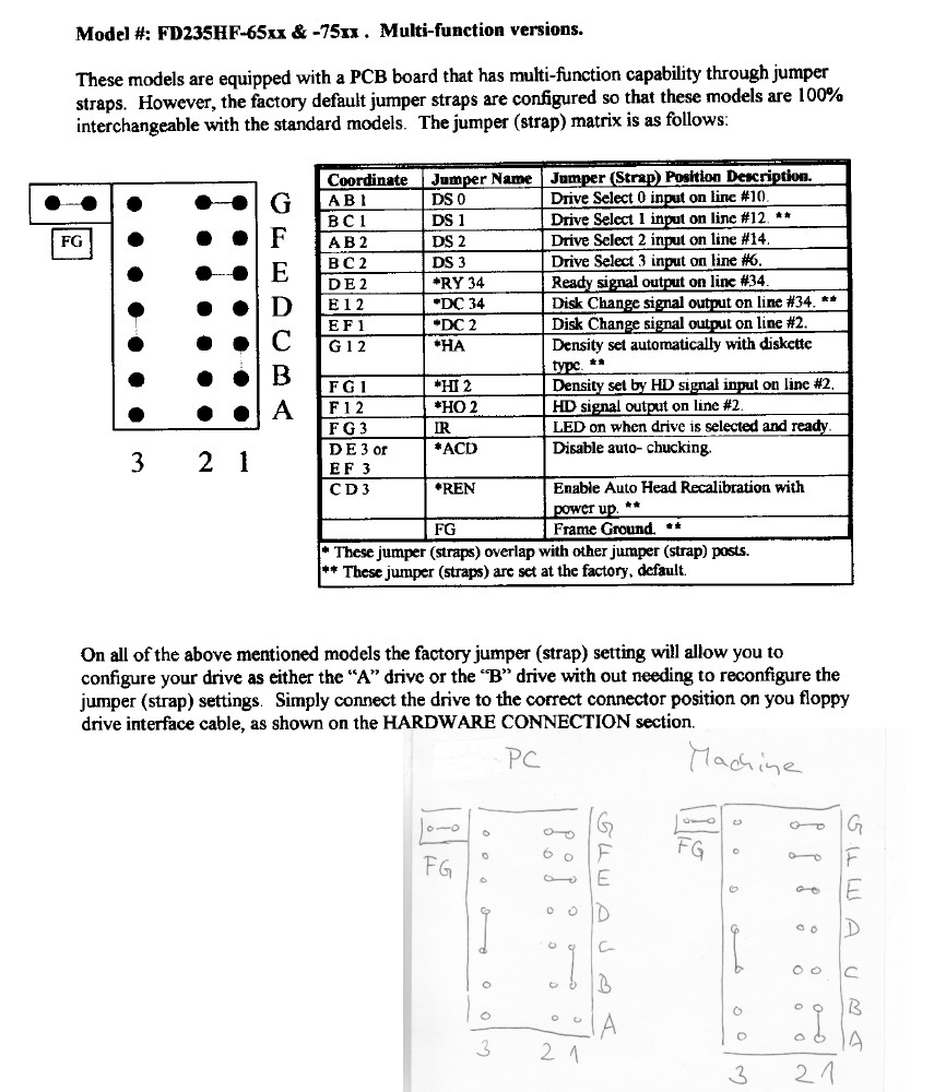

I have found old PDF with all specifications of this flopy disk, but I do not know how to adapt emulator to work with same setting (if is it posible).
http://www.teac.com/DSPD/pdf/3fd0020a.pdf

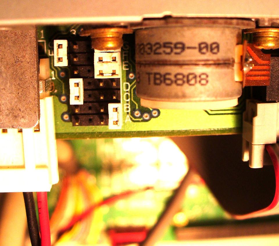

Relevant part of PDF from list 26 to 30. Iam also sending photo of my floppy with good visible jumpers.
Please help, any idea will be welcomed.

Please look for jumpers picure, there are few differences between classic FDD and rejumpered FDD, there are some input/otput changes, I do not understand it, but You will....

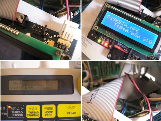

Re: replacement for FDD Teac FD-235HF-7579
Please to a picture of the hxc floppy emulator.
i want to see the jumper.
and how do you create the file image ?
do you use a special software to copy *.DST file on the floppy ?
do you got the same behavior/error with FDD2_DD.hfe ?
What means "yellow LED is flashing" ? what is the error exactly
this seems like the BAS 416A can read the floppy, but there are file missing ?
Can you dump/read a working floppy disk with the hxc software and send me the HFE file ?

last try - first picture - connected emulator and jumper position.
- second picture - image loaded to emulator. (green + red LEDs on)
- third picture error message on machine panel. (when I press "reading" on machine, middle LED is showing reading, also emulators beeper is pretending reading, but mechine reading error)
- fourth picture - cable from board to emulator. Not crossed.

If I look to FDD data manual, I could see that shugart interface is different that today "classic".
So please - if You look for changes that cause jumpers (earlier message from me), could You say me, which datacable interface is it?
Is it some standard? Or is it some industrial FDD with rare interface?
It is sure ALMOST like classic FDD interface, but not completely same.
