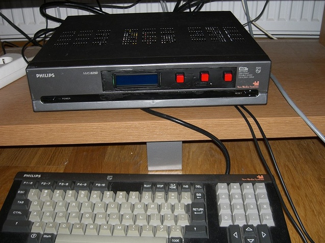

I installed the floppy emulator on an Philips NMS 8255 MSX2 machine. Sorry about this lengthy post and some bad English at places - I'm having a slight hangover and I'm not a native English speaker! Pictures are here.
I used polymorph plastic to make the new front panel to where the disk drives were. While doing that, I did some minor damage to the front panel :!: . Details below - in short: 1) The polymorph gets stuck very tightly on some kinds of plastics and 2) be careful if using a hot air blower near plastic, the melting point might be lower than you think!. So please read this carefully, if you're planning on doing something similar! :wink:
Also, when using polymorph plastic, some hot water and / or hot air blower is needed. So be careful and use common sense! I didn't get burned, btw :wink:
On the very close up pictures, you can see the scratches and dust on the cover of the NMS 8255. It has seen some life, and of course I could wipe some of it off ;-). Also, the damages I made can bee seen! It doesn't look that bad in reality, as in the close-ups.

*** 1 - The abandoned "Philips NMS front panel mold" -approach, and how the NMS panel got damaged ***
At first, I tried to use the front panel as a mold for the polymorph plastic. I put the NMS 8255 fron panel down on a table, and then put warmed polymorph in to the hole and tried mold it in place to the desired shape. But the polymorph cools down from the surface too fast, so corners and edges get irregularly "rounded" and look very ugly. I noticed that if I take smaller hot pieces of polymorph, I got a nicer edge by making it gradually - but then I got seams on the edges of individual polymorph peaces, which looked very ugly, and which I was not able to remove. After a few experiments, I abandoned this approach.
I tried one more approach with this "mold" idea. I made a slightly larger sheet than needed, heated it with a hot air blower on a glass table, and pressed the NMS front panel on this piece of polymorph plastic. The result seemed good, expect... the excess area of the sheet got stuck on the black stripe on the NMS front panel. Well, I thought no problem - I'll just use the hot air blower again to heat the polymorph to remove it from the panel. But, the polymorph was attached very tightly to the black stripe, where the reset and power buttons are on the front panel - in fact so tightly, that I haven't been able to remove all of the polymorph from the stripe to this day (can be seen in the pictures). Also, the black stripe warps a lot and very easily if warmed! This also happened while I tried to heat the polymorph to detach it from the stripe. Because of this, and trying to remove the polymorph, the black stripe got detached. I re-heated it on a table, made it straight and put it back in the NMS panel :wink:
Also, while I thought that the front panel plastic has a much higher melting point than polymorph, apparently it is not that much higher - and, also, heating with a hot air the surface of the plastic needs to be much higher so that also the inside of the polymorph gets warm enough - or, you need to be very slow / patient. But I wasn't, so also the grey front panel plastic got slightly molten while removing the polymorph (immediately when I noticed this, I was a little more careful with the hot air blower onwards).
You can see the damages from the pictures!
