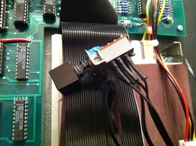

Re: SP1200 with external cased HxC Floppy Drive Emulator

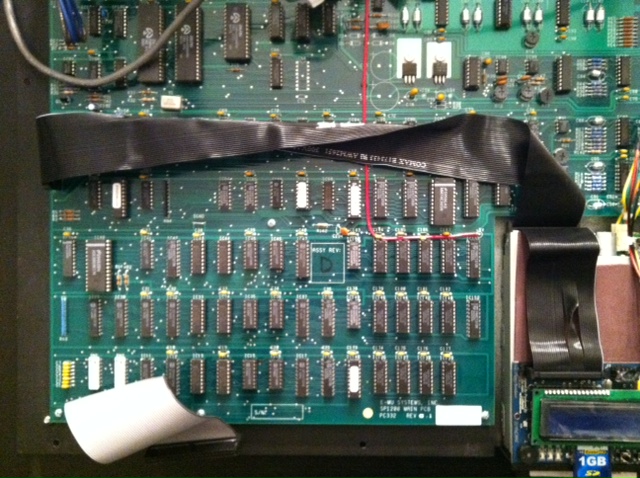

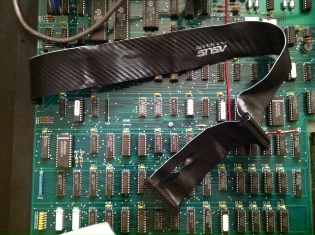

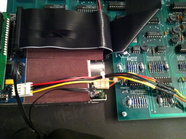

OK, here we go.
I built a split/parallel floppydrive cable.
I bought a pair of floppy cables (1euro/piece). I took off one of the plugs and installed it on the other cable.
as I will place the HxC on top of the floppydrive, the plug is just a few cm away from the plug, that leads into the HxC.
I installed a switch, that adresses the floppydrive to ID0, while the HxC is addressed to ID1. when switched on, the HxC is answering to the SP1200, while the floppydrive doesn´t react.
as long, the switch is off, you can load floppys from the drive. as soon, they are loaded up, you can switch to "on" position and the HxC is selected.
then you can save your sounds, loaded from the floppydisk, to the selected .hfe-file on the HxC.
The new floppydrivecable Cable installed Powersupply for both drives

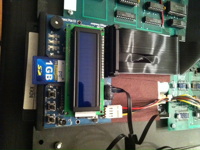

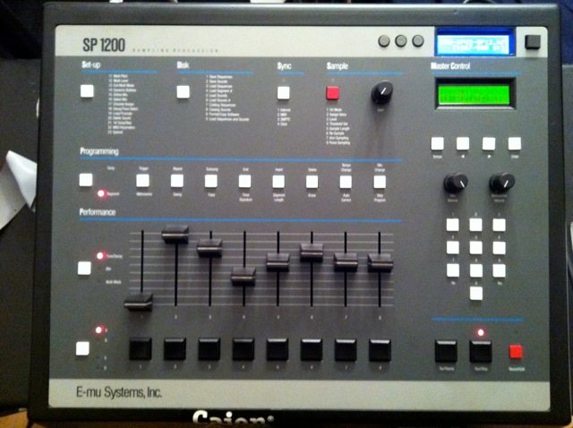

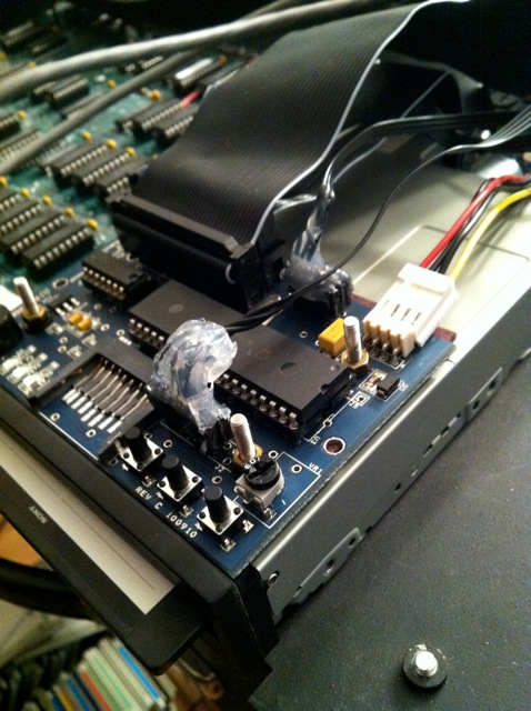

I put the HxC on top of the Floppydrive, as there is enough space inside the machine to do that.
I will find a way to mount the HxC to the FD. At the moment for testing, there´s just a layer of rubber to isolate the contacts from the metal of the FD case.
For the wireing of the addressbutton, I used the cable i had left from the two cables i bough. Also the plug can be used where the jumpers were. They fit. They just need to be cut off.
By the way. This is not the endversion of the build of course. Just the testphase.
I really found a good place for the display just above the SP1200 display. I will also install some extra select buttons for the HxC and the Switch for the selection of the drives.
This will be the new gereration of SP1200
To be continued.

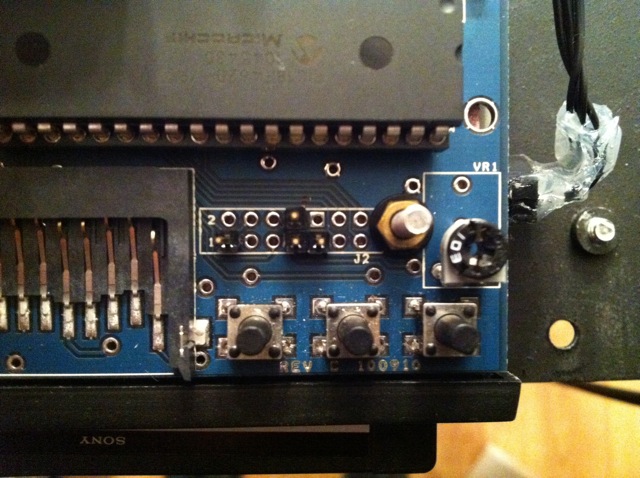

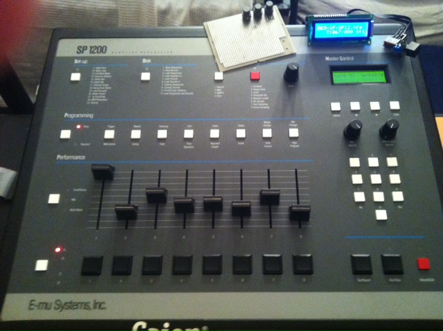

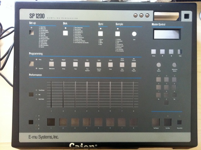

Ok, all cables lead to external control now.
BTW: you don´t need to unsolder the buttons on the HxC hardware. there´s J2 on the hardware, where you can connect buttons. (you need to check the schmatics)
now I´m able to use the machine, till I got the next and last step finished.
you can see the positions now, where I will place the parts into the SP body.
next step will be, to cut the body and build everything inside.
By the way. If someone need to know, how to address the SP 1200 FD, what is a Sony MPF420-2,
I found a page with the jumper´s settings. The page´s about the MPF420-1, but the settings are the same:
http://insight.actapricot.org/insight/c ... 420-1f.htm

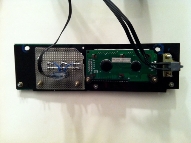

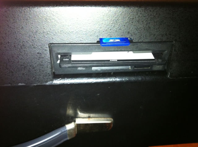

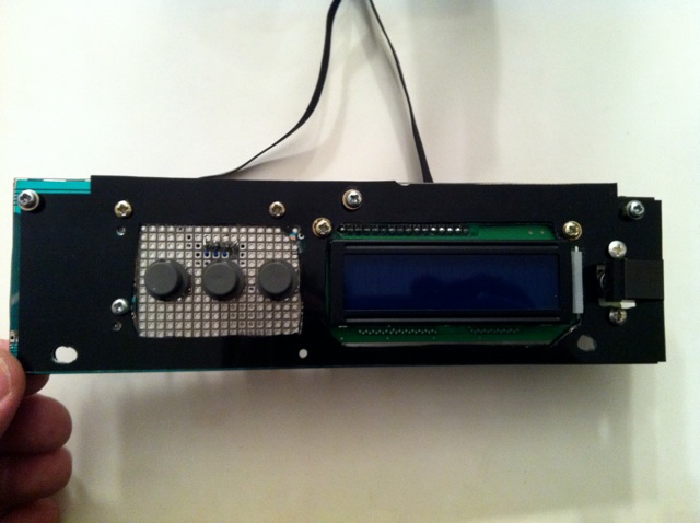

The SD slot.
Here the Body prepared for the display and the switches.
Here you can see the pins for the control buttons (J2)
Nice !
Just one thing : Be careful with the lcd's wires length.
Once connected try some write process on the HxC (some lcd signals are shared with the hxc sram chip...)
Thanks for the advice.Jeff wrote:Nice !
To connect the display, I used another of these 1Euro floppycables (just used one of the row of the plug), what works pretty good as they fit. It has the right lenght to still open and close the top of the SP1200. That way, there´s no need to solder something or extra create a cable. Cheap and fast solution.
As far as I tried, everything works ok. (I copied about 10 disks to the SD card).
Here you can see the mounted unit on top of the drive again (a rubberlayer isolates the board from shorts). I used plastic rings on the screws to avoid shorts)
Also you can see the Plug on the LCD con, the plug for external control and the one, that addresses the HxC.

Here it is. Sp1200 with both. Internal Drive and the HxC Floppydrive Emulator.
Video will follow.
Here you can see the parts I built in, carring the display, the control and the switch to change die IDs.
Here the other side:
Everything works fine. End of adventure!
