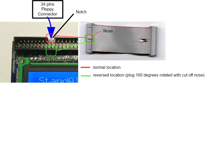

Atari ST/Amiga/Shugart jumper settings: Drive A, ID0, reverse floppy cable - cutting off connector's nose required!

Hi,Could anyone please explain in a little more detail how to get the sd floppy emulator to work in a yamaha tx16? I am new to all this and a little confused.What does reverse floppy cable and cut connectors nose mean?Sorry for my ignorance!Thanks....

Files sent!
I also try to explain the issue with the reversed cable and the plug's nose by means of the following picture:
- Nose_2.jpg (116.8 KiB) Viewed 130307 times
Re: YAMAHA TX16W
I have updated the Quick Install archive with the right images :Ohmen52 wrote:Files sent!
https://hxc2001.com/floppy_drive_emulat ... Images.zip
