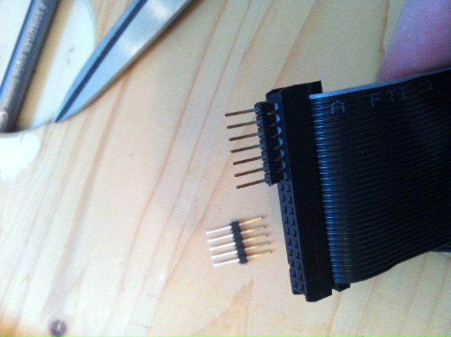

You can also use pins on the side of the ribbon cable, where you connect the display. You just need a row of these pins, you normaly solder on a board. If the pins are a little too long, you can simply cut them .
So there´s no need to solder. You just need to check to connect the plug the same way, that it is on the HxC.
