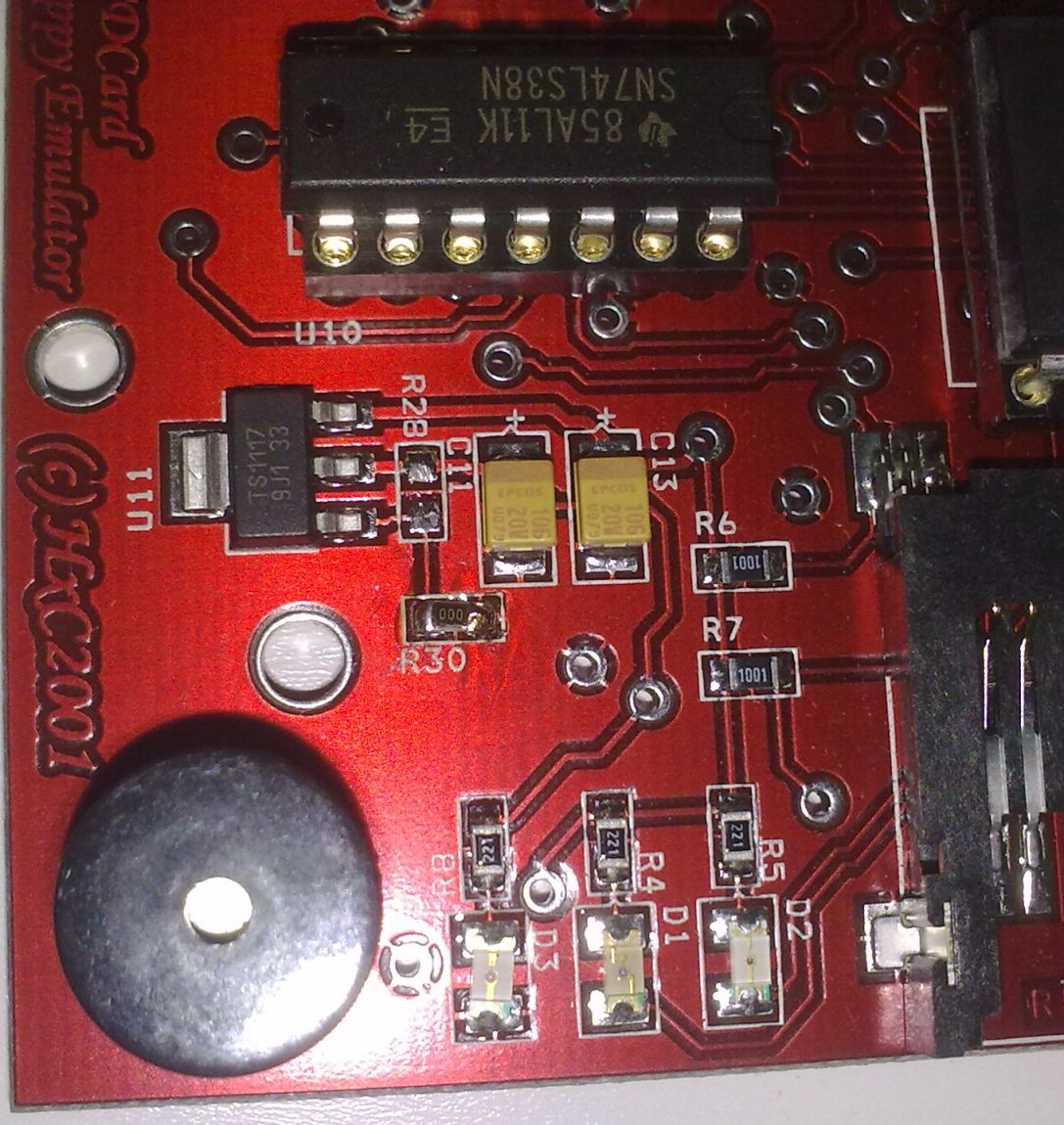

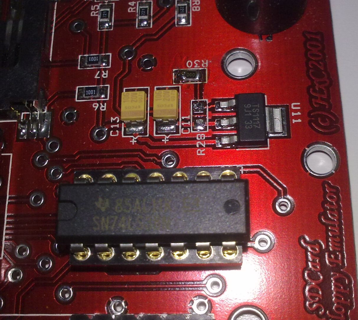

Hmmm, on my board there is no R28, just two empty solder pads. That would explain the problems.
Since there in no resistor there, I assume I should put a 180 ohm resistor there as in the rev 3 schematics. Or should I use 220 ohm since R30 is probably 360 (rev b) instead of 330 ohm (rev c)? Or maybe around 196 ohm (1800 parallel to 220) as result of the suggested modification to a rev B board?

robert2098 wrote:Hmmm, on my board there is no R28, just two empty solder pads. That would explain the problems.
Picture please... i cannot believe it...
Unless the smd component are nowadays too small for me to see with the naked eye, there is no R28. So better believe it :lol:
To convince you, I've attached two pictures of the 3.3V power regulator area of the board. Sorry for the bad quality but they were taken with my phone.
Robert
