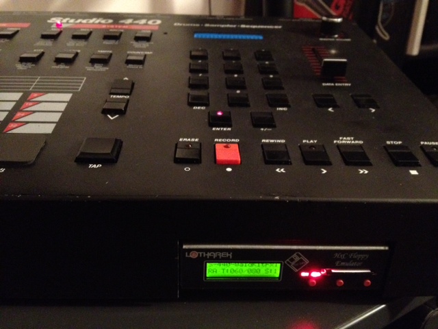

Finally I installed the Rev F version to the Studio 440.
- Studio440nHxC-F.JPG (99.63 KiB) Viewed 73904 times
