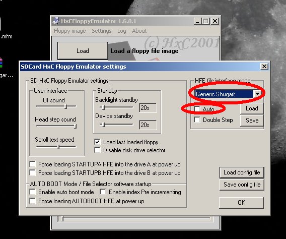

AleksandarK wrote: It works. Releif...
How can I make correct disk images ?
Just force the floppy image interface mode to "Generic Shugart" before export. (see attached picture).
You can load your HFE files and reexport them with the new setting.

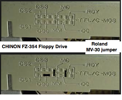

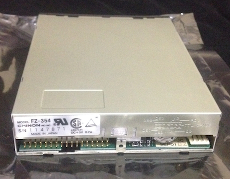

Roland MV-30 original drive (Chinon FZ-354) back view
Roland MV-30 (Chinon FZ-354) jumper settings </p>
Roland MV-30 chinon FZ-354 jumper settings
