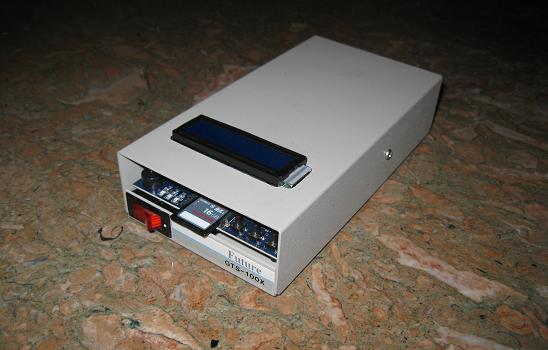

I know this is an ancient thread, but I wanted to share that I did this using a Rev.C SD HxC Floppy Emulator and an external floppy drive unit. The external floppy drive I have is an old Future Systems GTS 100X unit (this would also work with an Atari SF-314). Of course, the Rev. C board fit perfectly in place of the floppy drive, and I merely had to add a jumper (as described in the manual) for it to be recognized as the B drive (initially I made the mistake of thinking I only needed one jumper in the B drive position, but 2 jumpers are needed, as the manual illustrates). Also, I took the precaution of making sure the 5 volt lead was the correct one, and then disconnected the 12 volt wire.

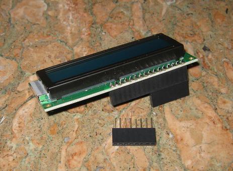

The cool thing was that the addition of a couple of Arduino headers raised the readout to the perfect height, so that all I had to do was cut a hole in the top of the housing for the readout to poke through.
This is a fantastic addition to my Atari 1040 STE computer!
