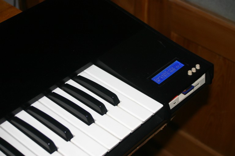

Re: Help! Roland S-50
Jean-François, merci.
I now have it installed and it works as it should. I'd like to know a bit more about the hfe image file format - I realized that when making speed higher the file size becomes bigger as well, and the file loads faster in my sampling keyboard, there are however limitations: Highest possible speed up until now I achieved for read/write support was a Bitrate of 265000.
Why are "faster" hfe's bigger than slower ones?
Thanks again
best wishes
Claudio
Thanks again
best wishes
Claudio
- S-50 HxC'ed
- IMG_3171_.jpg (57.23 KiB) Viewed 60230 times
