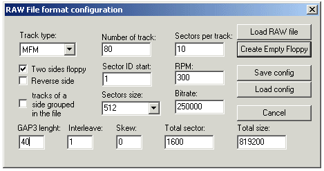

I have replaced the 3.5 inch floppy drive of the 1581 with a SD HxC floppy emulator and -indeed- it works!
However, the default (auto) conversion from .d81 format to .hfe is not functioning properly. The conversion from .hfe to .d81 (backward) is missing.
The solution: After encoding into MFM the contents of the .d81-file, the disk sides should be written to the disk in reversed order. Use the batch converter with "Treat input files as RAW files" option and check "Reverse side" option in "RAW File format configuration" window.
The reason: The 1581 is writing the signal for head 0 at the second side of the floppy and head 1 on the first side.
The long story:
1. With the program OmniFlop on a Windows PC, I have captured the 3.5 inch floppy disks in .d81 image-files.
2. With the batch converter, I have converted the .d81 images-files into .hfe images-files, using the default (auto,none) settings.
3. The HFE file interface mode was set to non-auto, Generic Shugart and the config-file "HXCSDFE.CFG" was written on a SDHC-card. The .hfe images-files were also stored on the same SDHC-card.
4. The removal of the 3.5 inch floppy drive from the 1581 was very easy. Just open the box (2 screws), detach both cables from the floppy drive, remove the mounting plate (4 screws) with the floppy drive and connect the SD HxC floppy emulator. Both power- and data cables are straight and must be connected in the normal way. The voltages of the power connector (CN1) and pin numbers of the data connector (CN2) are printed on the printed circuit board, so it is easy to verify the position of the connectors. The jumper on the floppy emulator must select DS0. That pin (#10) is hard-wired to ground at the controller while other drive select lines are open/not connected, so there is no other option.
5. After powering up the 1581, the Commodore computer, selecting a floppy image and retrieving a directory, the drive reported the error message: "74, DRIVE NOT READY, 00,00". The 1581 generated this error message for all floppy images.
6. However, trying to format a floppy image gave an usable formatted floppy image! 3160 blocks free.
7. Reading the modified .hfe image file, that was formatted with the 1581, unveiled the reason for not able to read the original .hfe image files. It turned out that the .d81 images files were not properly converted into .hfe image files.
8. The logical diskformat of the 1581 consists of 80 tracks (track#01-80) with 40 logical sectors each (sector#00-39), called blocks with 256 bytes each. The disklabel and diskid is written on track 40, sector 0 ($28,$00). The block availability map (BAM) is administered on ($28,$01) for tracks 01-40 and on ($28,$02) for tracks 41-80. The directory starts at ($28,$03). The first two bytes of each block points to the next block (logical track, logical sector) within the directory or an ordinary file. The .d81 specification says that it is a "byte for byte copy of a physical 1581 disk". It is however a byte for byte copy of all 40 sectors for each track of the logical 1581 disk.
The physical diskformat consists of 80 tracks (track#00-79) with 10 sectors (sector#1-10) of 512 bytes on each side of the disk (head#0-1). Two consecutive logical sectors (blocks, 256 bytes) are written in one physical sector (512 bytes). The logical sectors 00-19 are written in consecutive order with head id#0 on the second side of the disk. The logical sectors 20-39 are written with head id#1 on the first side of the disk.
9. Using the batch converter with adjusted settings, I was able to convert .d81 image files into working .hfe images files. Therefore you have to select "Treat input files as RAW files" option and change the parameters in the "RAW File format configuration" window:
- Track type: MFM
- Sector per track: 10
- Format value: 0
- Auto GAP3: not checked (optional)
- GAP3 length: 35 (optional)
- PRE GAP length: 2 (optional)
- Reverse side: checked!
I have tested some other values for GAP3 length (0-80) and pre-GAP length (0-20). All tested values seems to work correct. The mentioned values (GAP3: 35, pre-GAP: 2) gave the same timing (start sector cell, end sector cell) as a 1581 formatted .hfe image file when compared with the track analyzer.
The long story:
- Track type: MFM
- Format value: 0

Re: Commodore 1581 3.5 Drive Support
Thanks a lot for these very detailed informations, i will corrected the loader ASAP.
Now done on the beta PC versionJeff wrote:Thanks a lot for these very detailed informations, i will corrected the loader ASAP.
https://hxc2001.com/download/floppy_driv ... 2_beta.zip
