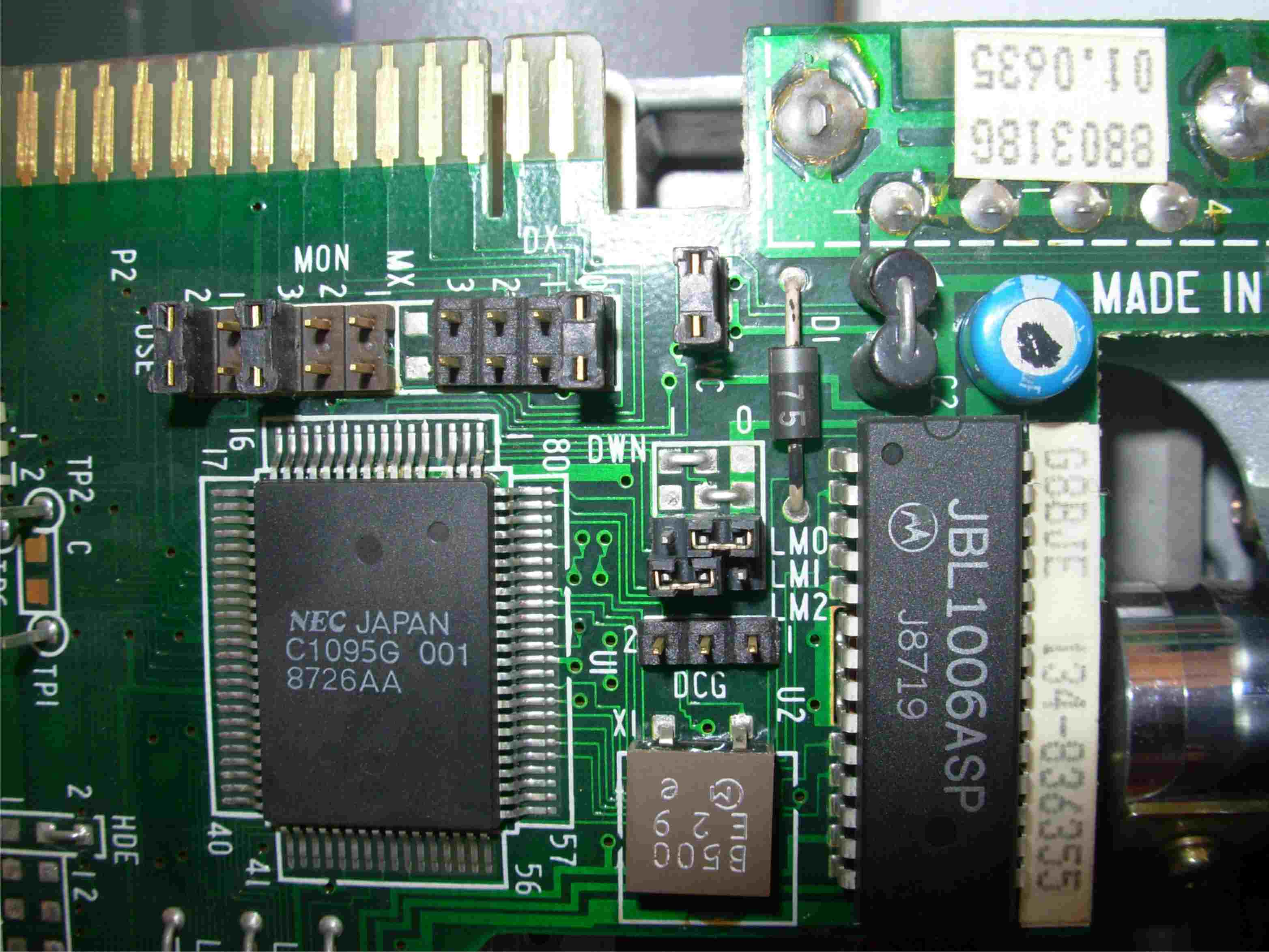

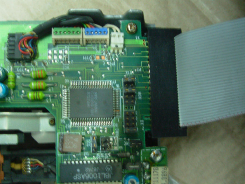

I append the photo of jumper setting floppy drive which is installed on the CNC machine.
Also I append the "hfe" file which can not be reading at the CNC machine .

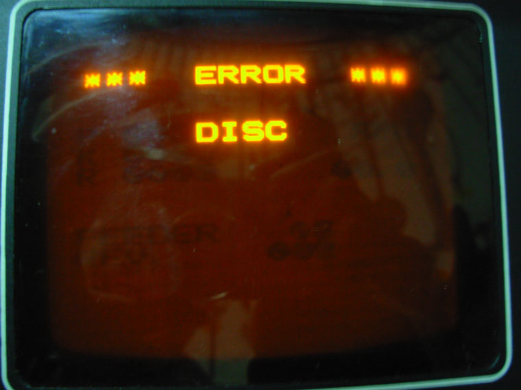

I got your files. Error as before
- file loaded
- DSCN0369_mod.jpg (52.5 KiB) Viewed 68641 times
- error on display CNC mashine
- DSCN0368_mod.jpg (58.73 KiB) Viewed 68641 times

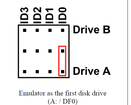

In the picture the floppy emulator jumper seems to be in the wrong position.
Try the --ID0-Drive A-- jumper position or the --ID3-Drive A-- jumper position.
The floppy emulator must at least show you that the CNC machine is trying to read the virtual disk.
You should get a "RA" message on the lcd when the CNC read the disk.
If not the jumper position is wrong.

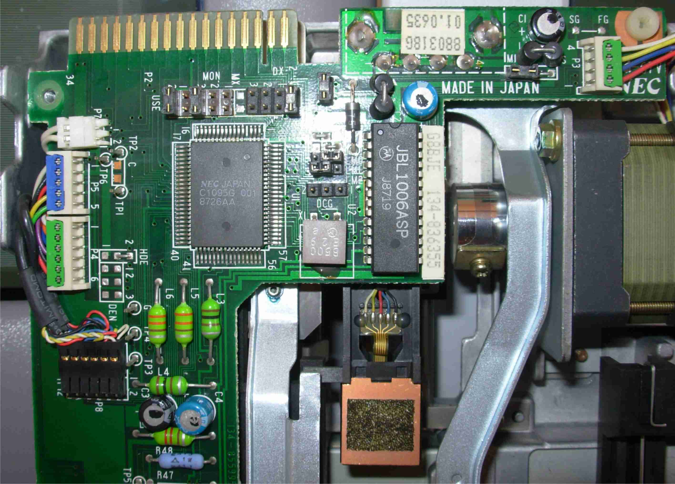

what is jumper setting should be on your device and what HFE files must be installed, if the original floppy NEC FD1054
is connected to the machine CNC non twisted cable and original jumper setting of floppy NEC FD1054 is on the attached photos
This is some information about floppy NEC FD1054:

Try the jumper position showed in diagram showed below.Jeff wrote:Hi,seaman_2007 wrote:I got your files. Error as before
Best Regards,
Jean-François DEL NERO

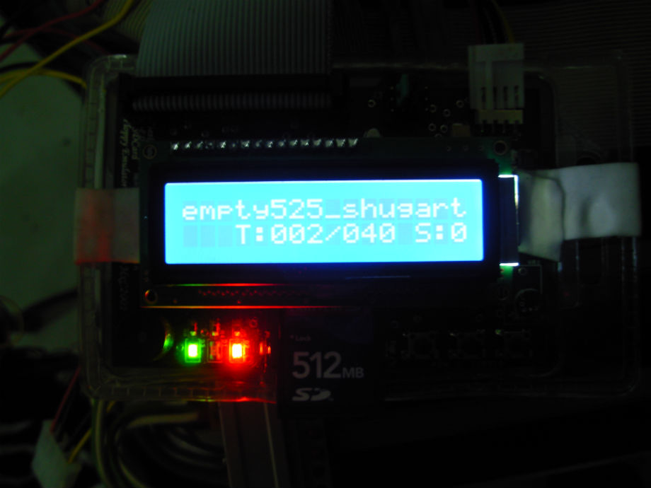

Jumper is included in your instructions, but the error remains the same - DISK ERROR on CNC machine. Displayed on the emulator RA Message <<RA T:000/40 S:0>>

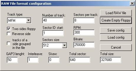

The sequence of my actions when creating a disk was as follows:
I took a dump diskettes, shot with a pre-formatted with a specialized program on the computer running the operating system DOS. On this basis, it was found that the floppy has the following format 320 KB 40-Track 8 sectors.
Emulator was created following a floppy disk and written to the SD card emulator.
<pic1>
What has changed as a test of the value of GAP3 ranging from 40 to 70. Unfortunately I could not not format does not write data to the emulator.

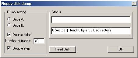

Then I did a dump directly from this drive, the menu item «Floppy disk dump».
<pic2>
Dump is created without errors. This type of dump emulated but not completely. That is, write the data I could! And here is a specialized program to format a floppy disk failed.
<pic1>
<pic2>
