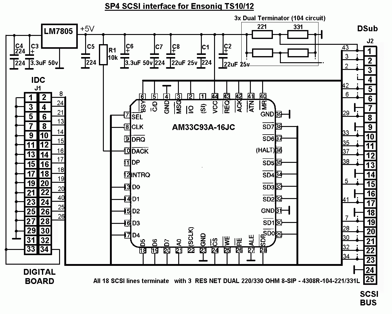

I have optional SP-4 SCSI interface for my Ensoniq TS10. And my ASR-10 rack has SP-3 SCSI interface.
Unfortunately, SP-4 has read-only option only, although SP-3 (which a has similar scheme) has both read and write options.
It seems, it is TS10/TS12 firmware limitation for copyright purposes.
I have drawn the scheme of my SP-4 SCSI interface from PCB. I can add photos of both sides of PCB itself, if necessary. Datasheet of AM33C93A SCSI-bus interface controller may be useful too.
For my opinion, it should be a good idea to do SD to SCSI emulator and connect it directly to digital board (i.e. to emulate AM33C93A SCSI-bus interface controller with peripheral devices).
Due the fact that SCSI file system are similar with FDD, it is possible to use FDD images as SCSI subdirectories. Here is an example how to do your own CD from floppies http://www.chickensys.com/kb/eps-asr/034.html
Regards,
Youriy.

Thank you so much for posting the schematic. If you get time, it would be great if you could post pictures of the PCB. I never knew that the SP-4 is a read-only board. Also, isn't the SP-3 just for the ASR-10 keyboards?
Moe
Moe
