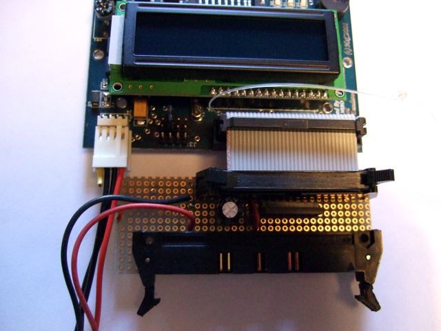

When not writing there is a 500kHz clock signal at pin 22 (WD). The emulator has only 1K pullups on incoming signals and the cable is about 1M long with no other drives on it, so the signal looked rather poor with slow risetime and considerable overshoot at the bottom (photo attached). So I put 2 resistor networks, 270 & 330 ohms, on incoming signals as close as possible to the emulator. 270 (in parallel with the 1K) to +5V, 330 to ground closely approximates the 220/330 ohms a terminated drive would have. I also put a 330uF capacitor and a .02uF disc close to the SIP resistors for filtering. The signal looks much better now (but I didn't take another pictureWETO means-> Write Error Time Out

I'll attach world256.imd. I started by formatting a floppy with 256-byte sectors and putting a small text file on it (it says "HELLO WORLD".) As I noted before, FORMAT doesn't touch the first cylinder and the first track is preformatted at 250kb/s. You can see that in the .imd file, so I edited a copy to define the first track the same as the others. For convenience I used the compressed notation to fill all 26 sectors with 00h. Both versions produce a readable .hfe file.-> or an attempt to write sector with a "deleted address mark".

- 50-34 pin adapter w/termination
