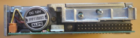

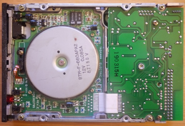

It would be really cool if the floppy emulator could be used with an Akai S950 Sampler. Maybe I can provide the necessary information (Drive Model, Floppy Images etc.).
sincerely
Jan
a picture of the internal floppy connection is a good start.

- s950_floppy_bottom.jpg (104.41 KiB) Viewed 246358 times
- s950_floppy_back.jpg (27.29 KiB) Viewed 246358 times

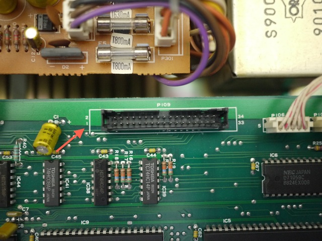

Today I hooked up the SDCard Floppy Emulator with my Akai S950 and successfully stored a freshly sampled sound on the sdcard, switch the 950 off and on and successfully loaded the sample:)
Initially the disk LED was permanently on so I opened the S950. The floppy connector on the mainboard of the S950 (see the attached picture) is reversed. I cut off the plastic thing on the plug on one side of the ribbon cable, so i could connect it in reverse. Now the LED stopped being permanently on. I used a custom raw floppy image with the following setting:
Track type: MFM
Number of tracks: 80
Sectors per track: 5
Two sides floppy
Sector ID start: 1
RPM: 300
Sector size: 1024
Bitrate: 250000
GAP3 length: 50
Interleave: 1
Skew: 0
Total Sector: 800
Total Size: 819200
Now I'm going to build a nice case for the floppy emulator to fit in the drive bay of the s950.
