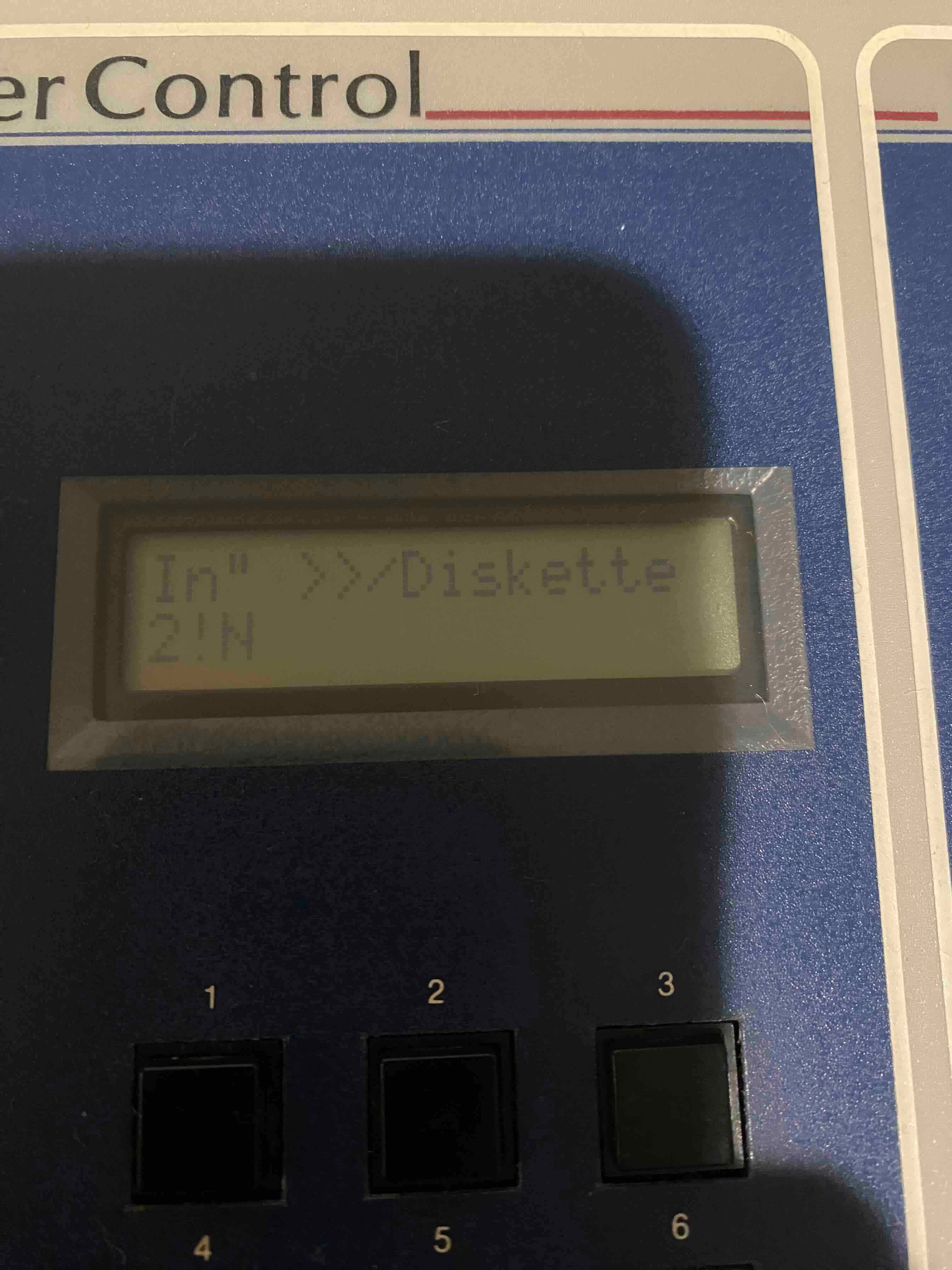

please share a picture of the E II screen.
Re: HXC Emulator Woes Please help
Many thanks for your reply I really appreciate it.
I have attached one of the images. I think this may be fixed now due to the correct indexing however I am still unable to load the files from the HXC
- IMG_3131.jpg (253.74 KiB) Viewed 79143 times

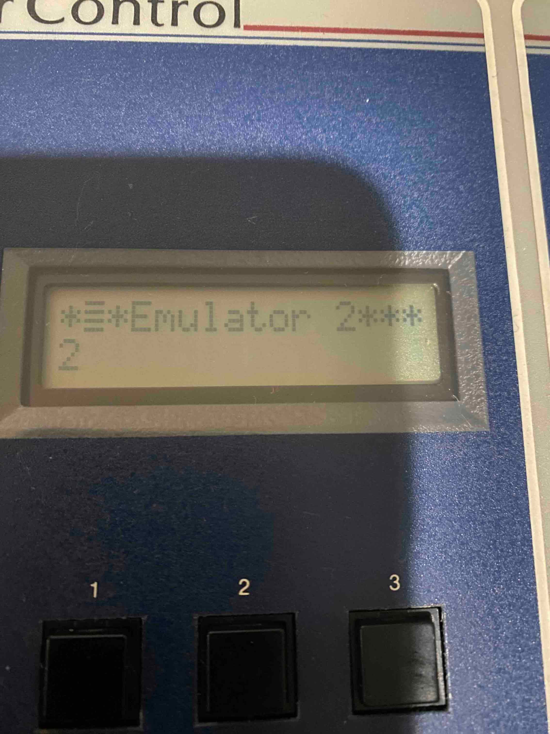

and here is the other one
Do you knwo which IC's are related to the Disk drive operation?
- IMG_3132.jpg (196.01 KiB) Viewed 79143 times

I suspect a general power supply / capacitor issue on this machine.
Do you get similar lcd issue when the hxc is not connected ?
The whole psu has been replaced by one made by synthchaser.
I don't think the display was like this before the hxc except I was not able to load the os as the original disk was corrupted.
Looks like you have problems with the DRAM in your Emulator. The first bank which is IC13-20 in the main CPU board needs to be working before the EII boots correctly. This is part of the working address space for the OS. If you have something like an RCT or an Inquisitor which can check 4164 DRAM ICs then I would strongly suggest you test them. They are a high failure items and very static sensitive so do take all precautions. Post back on here if you still can't get it working we have had many EII in for service and have seen a lot of it. Some of the other buffering circuits which join the memory data bus back to the CPU might also have failed as well. If you are setting up an EII with an HxC always use the Quick floppy images and also use the memory test disk which is part of the pack. However, be aware these won't work if your DRAM has failed at a low address!
